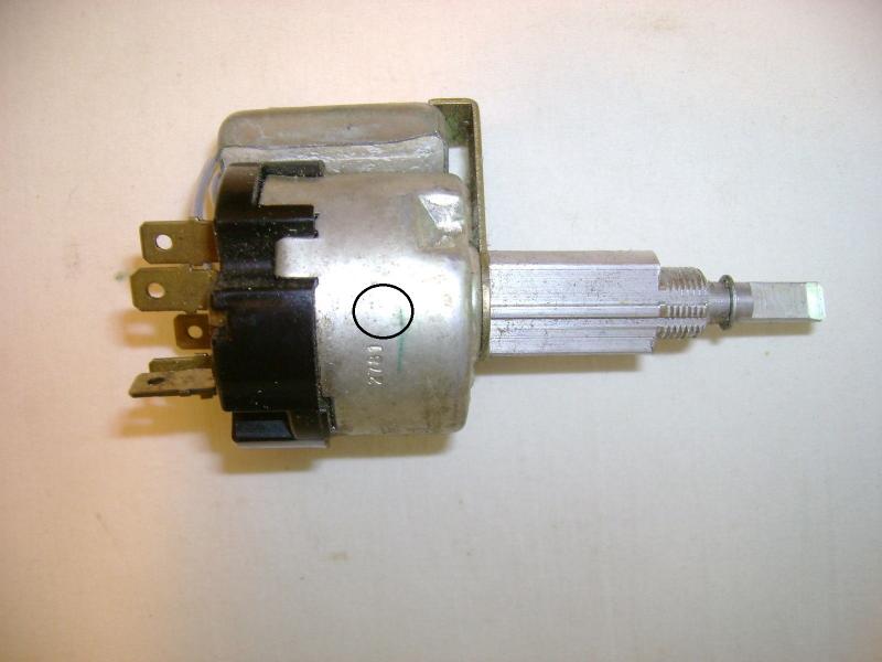

This is the back of a 1970 3 speed switch, note the resistor, should be about the same as yours.
Thats almost spot on to mine but I have an extra black wire soldered to the side of the cylinder. It looks like its supposed to be there but I havent seen anything close to it online.

Now, talking about wires... I can recall on ANY 3rd gen assembly any Black wire, just pink which is the main power source, brown which is the washer then all the same wires arriving to motor ( blue, red, green and another brown ).
Switch gets ground actually from chassis, so maybe was an extra reinforcement from earlier owner ?
as stated ALL SETUPS got same wiring. nothing extra for diff function.
Yeah thats, what I was thinking myself. Mine looks exactly like this one and I put a circle where the wire is. My brother did have an issue with an electrical short and its possible it could have melted into it but that seems unlikely. I will still post a true picture tonight so I can get feed back. It just doesnt make any sense to me why a wire would be soldered there. Is $250 a good price for this switch or are there better alternative should I need a new one? Thanks again for the help!
I don't think is bad, just got a ground reinforcement for whatever reason... despite/remove the wire, and try to use it without that. Reinforce instead the ground to the cluster.

anyway, my suggestion is, fit and test your one, I bet is not bad

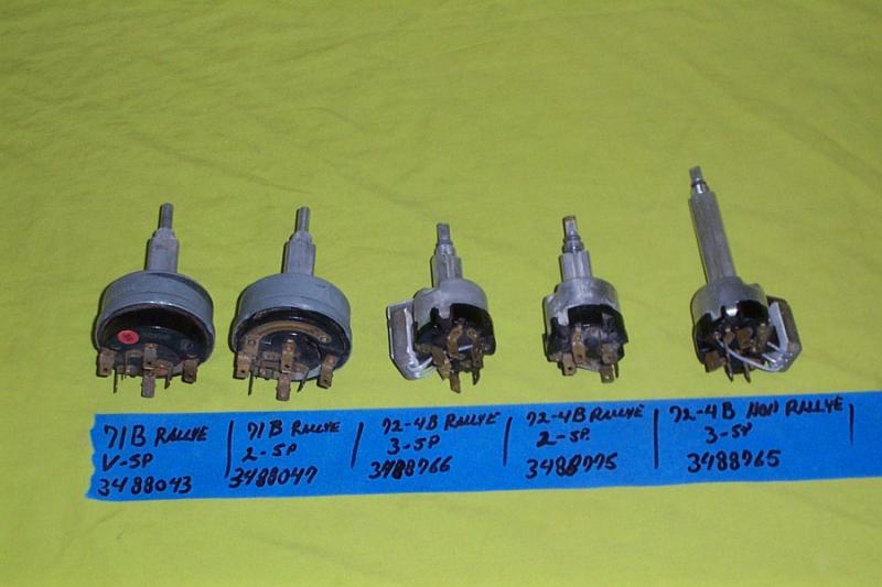

Here are the 71-4B W/switches. As Nacho stated the V/speed is 71 and actually early 72. Then was placed with the 3-spd. No ground wire on the switch housing.
