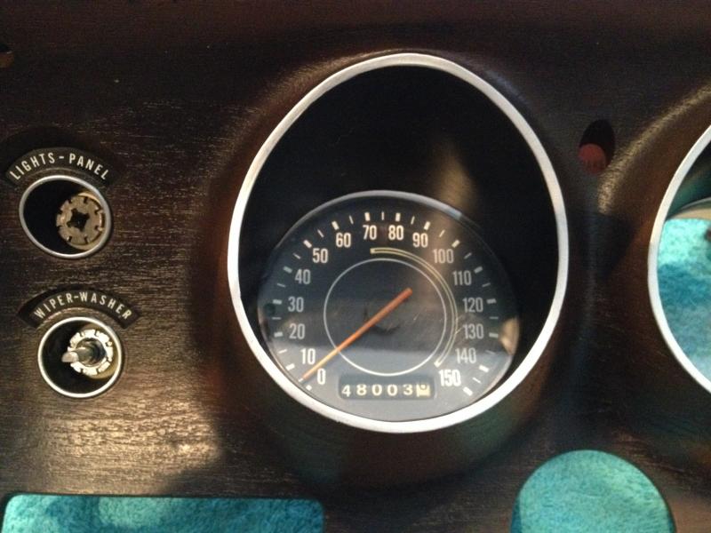

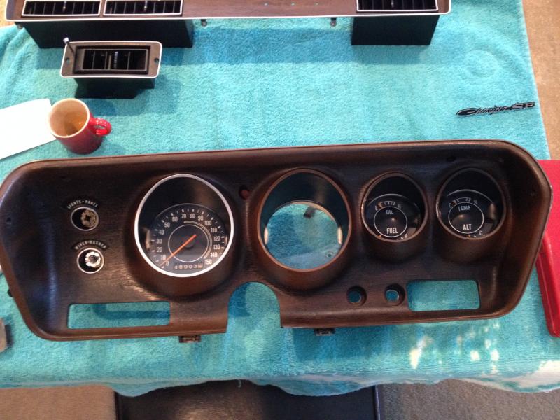

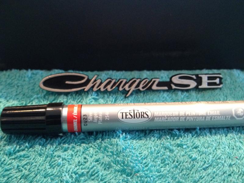

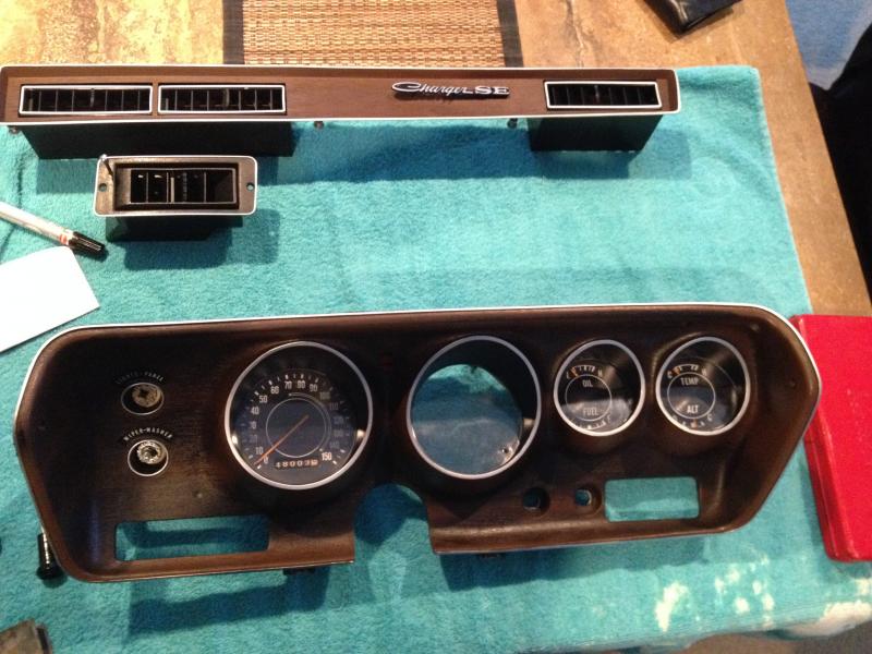

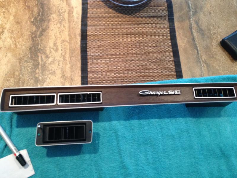

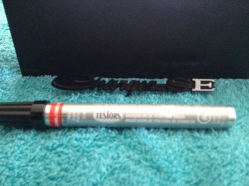

Iv'e been restoring the cluster for my dash and thought I would share with you how I duplicated the silver trim. I used an enamel paint pen (Testors brand). Its worked out really great, and being enamel it does not come off. I have to admit that it is not exactly the same as the factory, because they had a finish that looked exactly like chrome. But its pretty close and because I had to redo the whole lot, there is none of the original finish to compare it to. Anyway, I thought I would share some pictures.
Nice work so far Jason :headbang:
I did some with a Sharpie brand paint pen and it came out similar.
I like the enamel idea better, so I guess I'll try to track down a Testors pen.
Looks good Jason.
I used the Testors one as well but I'm not sure if it was enamel, I'll have to check that.
I say that because I also used it on my side markers and had to redo do those once already.
Looks good Jason.
Yes it's definitely enamel. I dare say that an acrylic type is available as well but mine is enamel. Seems to have bonded really well.

I've used those pens for years.
They work great! Like you said, not 100% correct, but unless you're looking for show quality, it's great.
They are so easy to use, and very easy to control the flow so it comes out nice and smooth and even.

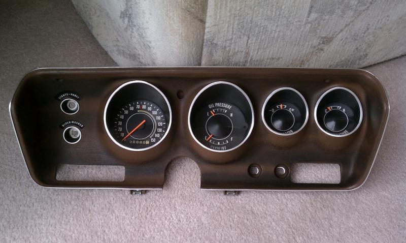

Here is what mine looks like
