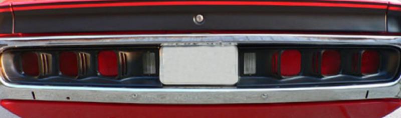

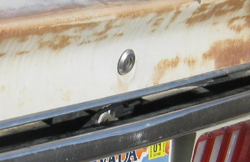

Also the 71-72 vs the 73-74 Charger deck lids also had different indentations for the lock cylinders. The 71-72s had a full circle indentation while the 73-74s had a half circle indentation.
