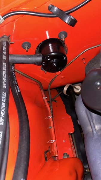

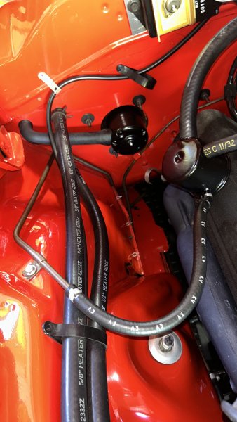

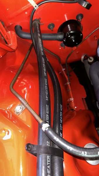

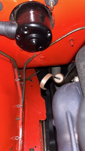

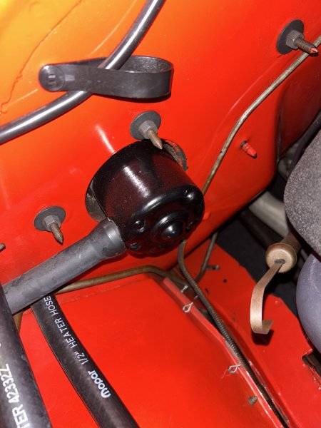

Guys, I'm looking for close up pics of the 1971 B-body fuel vapour return line.
Specifically how it runs on the passenger inner fender to the firewall and down.
I want to mount one on my Runner as the inner fender has the indent and mounting hole for the clip that holds the line in place.
