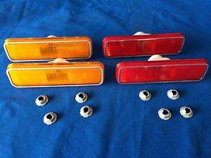

2. Side marker lights- On the bezels are the studs suppose to be threaded? Also, size and correct acorn nuts? I think they're a 10-24 thread(?)

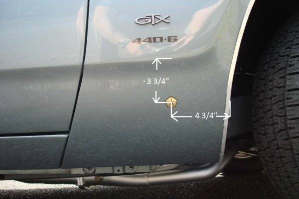

3. Pentastar- Anyone have the dimensions for the emblem on right fender? Body shop didn't note the location and hung the fender. Not sure if I'll be able to find it from the backside or not.

This is a GTX but might be the same. If the side marker light bezels are like the 69 they are not threaded and the threads are cut with the speed nuts. As for size I have no idea.
That’s my car, the position pictured was carefully located from a ’71 fender that came on one of my ’72 Sats, not original to my ’72 RR/GTX. They stopped putting them on sometime very early in ’72 production.

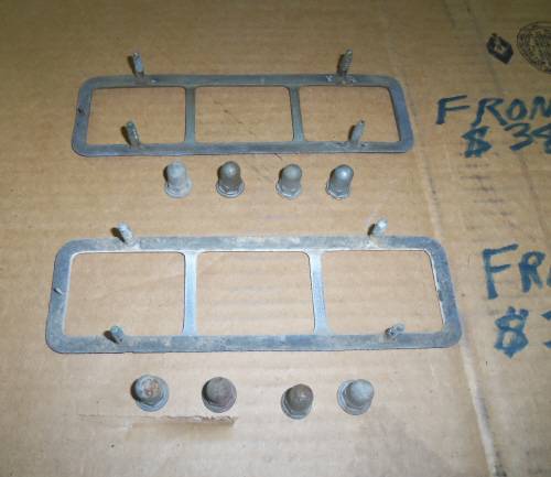

I have several 71 side marker bezels...they all have threads of sorts...not sure if they were machined on or created when the nuts were spun on.
i have about a half dozen nos markers and a few nos bezels in my stash and
there are no threads on the bezels at all
the threads were created by the nut.

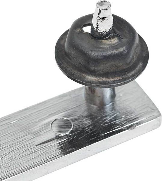

Those nuts are just like this, just capped
as mentioned, federated nuts use those, in 1/2" hex size
They are similar and yes, they are self cutting and enclosed but have something inside of it to protect from weather
yes, a sealer like the used on body seams... that's important on rear but not THAT important on fronts. Federated sidemarkers got a foam gasket to save that.
