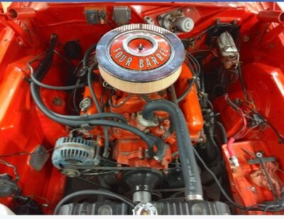

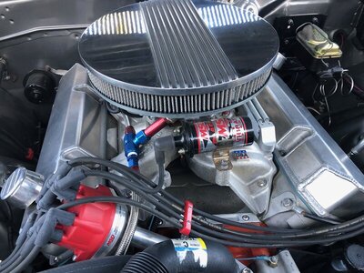

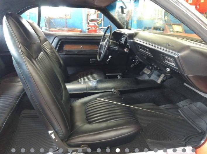

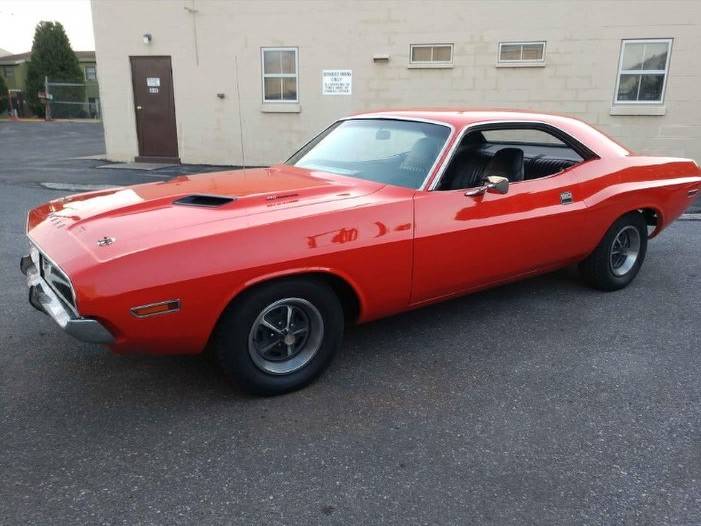

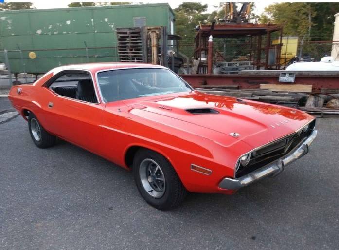

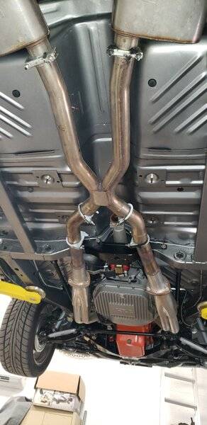

Hi Happy New Year to all. To see what you guys think? its a 71 challenger supposedly rt 340engine they want 33k "1971 challenger rt,340 v8 auto trans newly restored very straight body new black interior with original floor shifter.

That's about right. $25 is too cheap and $40 is a stretch.
For me, $33k would be a stretch. Some would be happy to pay that and mike is probably right but it is a Factory 318 car. If you wait and look around you can get a proper A66 code (factory 340) car in about that range, perhaps and touch bit more but would be money well spent. Your investment would be better protected too. All this is in my opinion though.
It looks like a nice car however.
Looking quickly at the pictures I see, wrong mirrors, its got an A/C dash but the firewall is not an A/C car, the quarters look funny behind the wheels like they are shoved up to meet the trunk extensions. You can find better for that money.

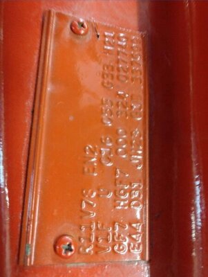

That will teach me to look at this thread on my phone. Fender tag is as big as a postage stamp. LOL
I could be wrong, but I thought 70/71 had no bumperettes, 72 had small ones like what’s shown, and 73/74 had the big ones. Willing to be corrected.
thank you very much.. yr looks like 73?
Yes, it looks like a '73 VIN. Most of the important info is on the last line, especially (if I can read it, cuz it's slightly unclear) the "G3B". G = 318. 3 = 1973. B is the plant (Hamtramck) just for your info.

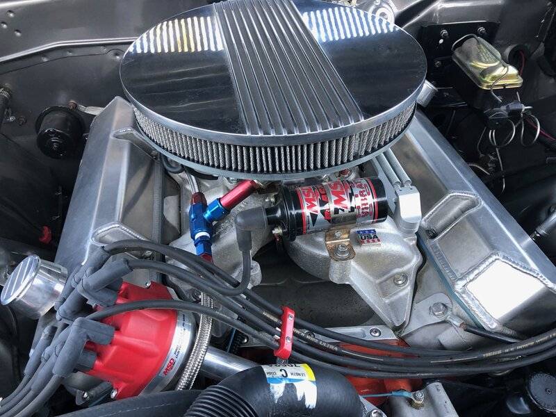

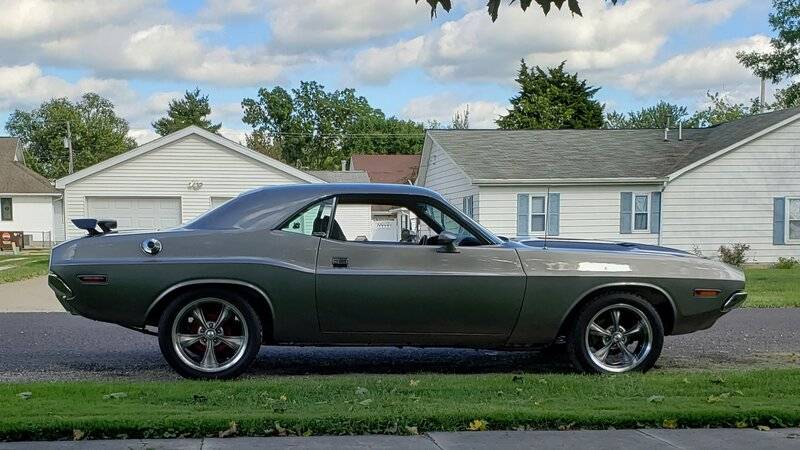

Let me put my 2 cents in here. My E body is the only car I have purchased "finished". It was around the price of the 2 cars you have posted that you are interested in. Mine is a 71, originally a 318 car. I could care less about #'s matching and, couldn't afford all that in an E body anyway. My car was done on a rotisserie and the bottom looks as good as the top side. All the interior was new with leather seats the only thing I had to do inside was a new set of front door panels. The car is literally like new with small things needing addressed as they are never perfect. The motor is a 512 stroker that makes 581hp and 686ft lbs of torque and had around 1000 miles on it when I bought it. If you keep searching you will find the right one at the right price. Not sure what VANDAN is asking for his but, it looks sweet from the pictures.
Below are pictures of mine...Be patient the right one will pop up...
