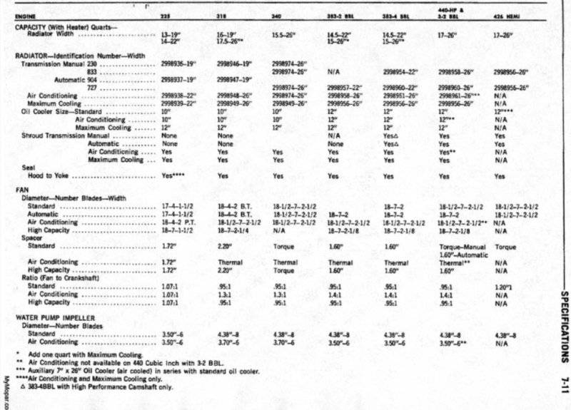

Can't access my FSM on CD for a minute as my computer is down. What is the correct fan and spacer set up for this car? Thanks for any help
All 1971 Mopars used a fan clutch. A 383 w a/c would have an 18-1/2" 7 blade fan and 26" radiator.
