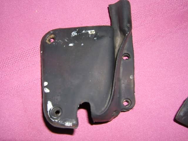

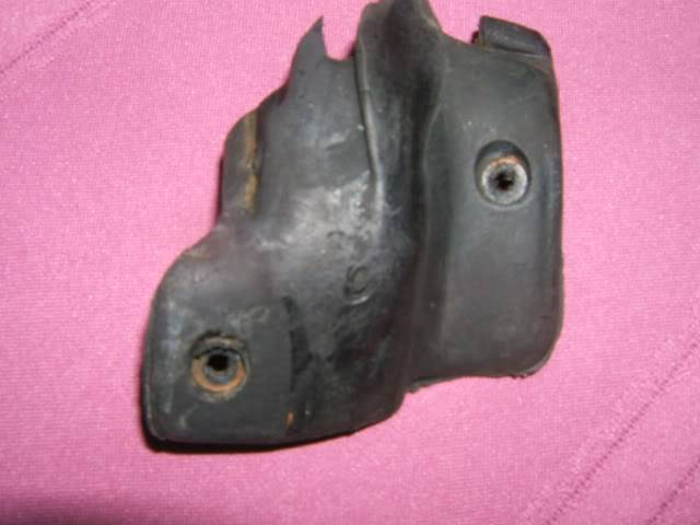

Okay, so here is where we are at. Can't seem to find anyone that knows the part name or number for this weatherstrip. I bought a "complete" weatherstrip kit from a well known Mopar supplier and emailed them about not having these. They replied..."there is nothing other than the weatherstrip that goes around the door on a 71 Charger". So here is a picture of a piece of weatherstrip...anyone know?

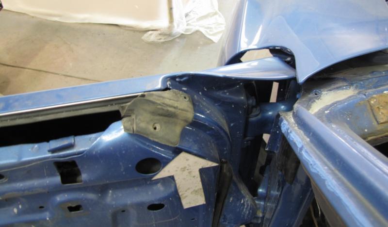

I found a similar pic of the same part. However there appears to be only 2 mounting holes in the piece on my car. Then there are 4 on the replacement part? It also appears that the part on my car (pic sent by shop reassembling the car), the part we are looking for does not go down the door to meet the weatherstrip....
so I hope someone will post a pic of their "correct" installed weatherstrip! :grin:
So does that piece on your door just have 2 mounting holes also? Everything I have found online (new replacement part) shows to have 4 holes?

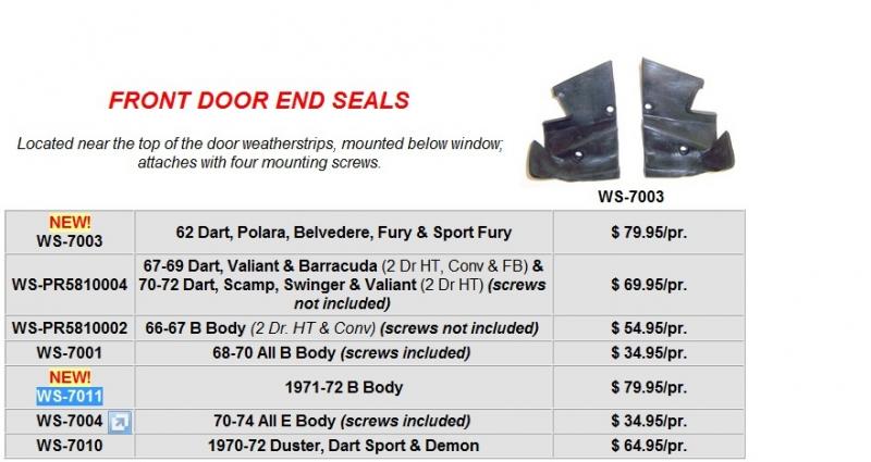

Also found this listed at Jim's Auto Parts but picture is "unavailable" and there was not an email address listed on his site. So it is a guess what part WS-7011 looks like...:icon_confused:
I zoomed closer in on my pic, looks like just 2 holes for screws. I can check the other car next time I am at my shop.
they are 2 different parts that go in different places
one doesn't take the place of the other..
the 2 screw one goes on the front of window
the 4 screw one goes on the rear
both of these parts came off a 71 sat door
i bet a 71 charger is the same animal...

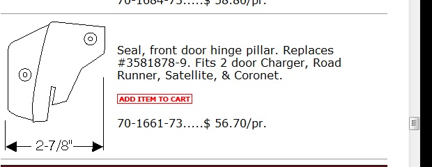

A tip from Moparts lead me to Steele Rubber. They had the replacements in stock so I ordered a set. Now just have to wait to see if they fit.......
