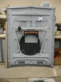

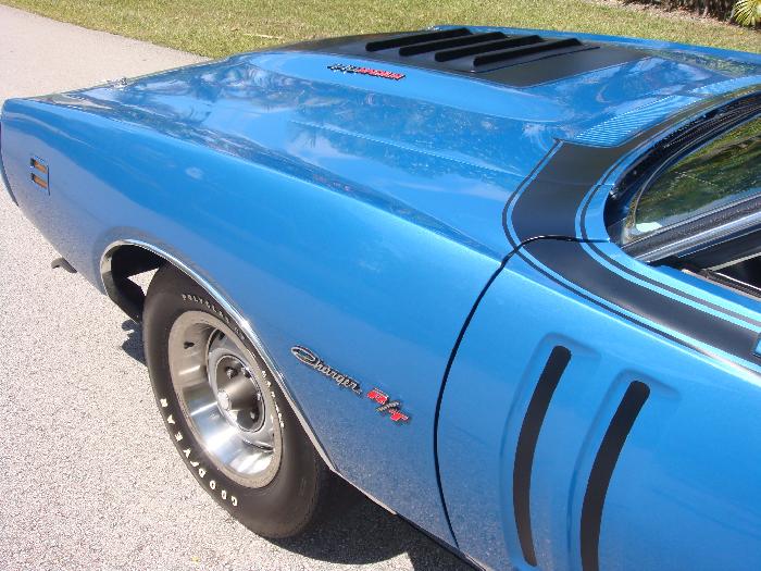

I was wondering if anyone knows if the stock Charger R/ T with the louvers is the same hood used on the air grabber option. It looks to me that the air grabber opening is smaller. I would like to convert my 71 R/T to an air grabber and want to know if I need to swap out the whole hood or will mine work?Thanks for any information.
I am pretty certain it is......but no Charger ever had an air grabber option.
The R/T Hood is different. Yes they did in 71-72 it's called the N96 code try the 71 Superbee registry they also have a 71 R/T registry there too.
R/T hood is different than the N96 hood which is based on the Rallye hood.
Rusty is correct in that the Dodges had a Ramcharger hood. Same difference.
Yeah, like Mark said and I before him. NO Dodge ever came with an Air Grabber. Air Grabber was a Plymouth option. Ram Charger is what Dodge came with.
the RT louvers and bee hood insert interchange . the ramcharger (dodge) does not fit in those hoods. they are their own hood. i would imagine you can MAKE it work with some creative fab work.

Or find a Rallye hood and convert it. Same can be done with a Satellite hood for an Air Grabber.
