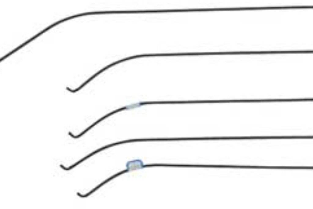

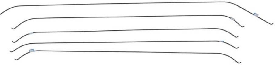

I wonder if I can find the clips that come with new ones for my old ones? Pics from CI seem to show clips.

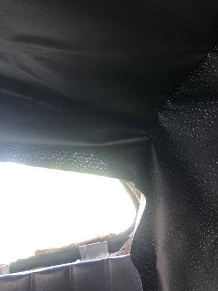

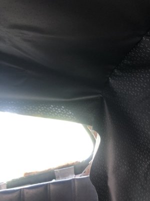

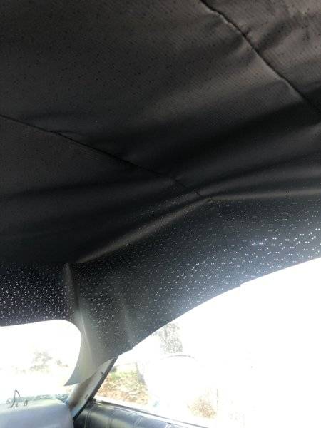

Any advice? My front and rear most bows are really tugging on each other. It’s a 4 bow headliner.
