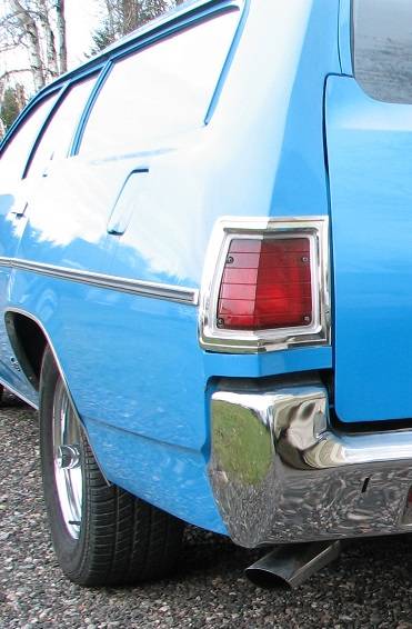

Here's a picture of my wagon's driver's quarter panel. The fuel tank is right behind the quarter panel, even with the fuel door.

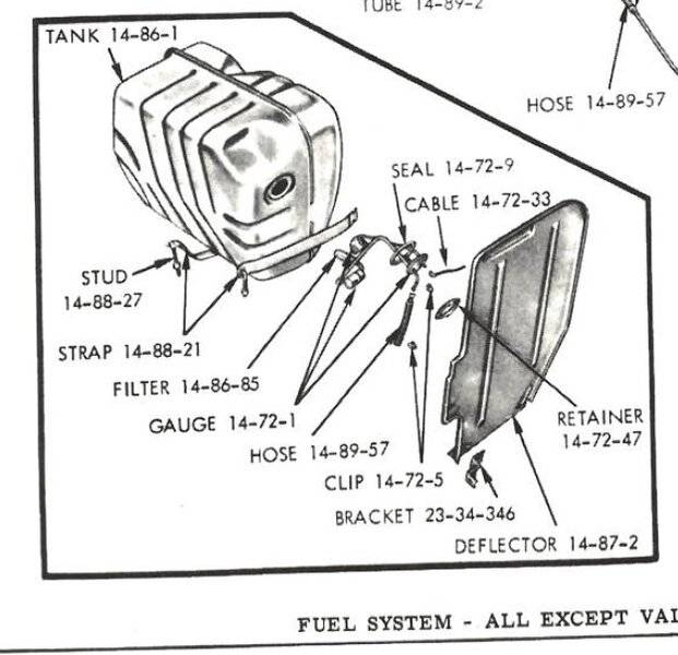

Also, a picture from the 1972 parts book. The deflector shown is facing the rear tire.
The part numbers for 1972 are:
3466153 - up to April 1972
3642170 - after April 1972
Maybe have the person go to their local dealer and have these numbers checked for supersedes up to 1978 and hopefully find a tank somewhere.

The above photo, it is upside-down - bottom facing up. The port showing, is the sending unit/pickup port, in the forward face (faces the rear wheel).
