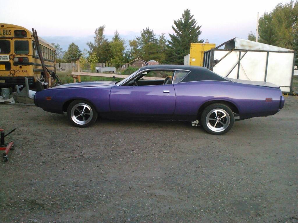

Here is how it sits right now. Needs to come down for sure if I run these rims.
Quarter fender gap much more noticeable with the 17" on vs the 15" rim. A quick photoshop and here is roughly where I think it needs to sit. Opinions?

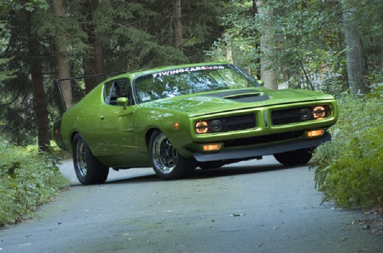

I would go with hemi springs from Espo. Had them on my Challenger and they gave a great rake. They were not 1" over or anything either, just their stock hemi springs. The biggest you could go on an ebody was 275/60/15s on the rear and 235/60/15s on the front with a stock wheel, but I think you can go a bit taller on the Bs. Why not email Gary and Pam? I'm sure they would tell you what size tires they are running. That car was in Mopar Action, I'll see if I can find the article. If you think it's too high after you get the springs in you can buy an adjustable rear shackle kit from Just Suspension and flip the front hangers to get a little drop.
