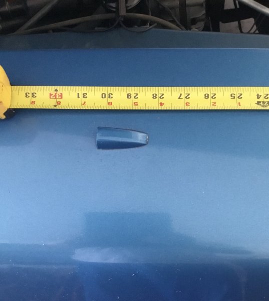

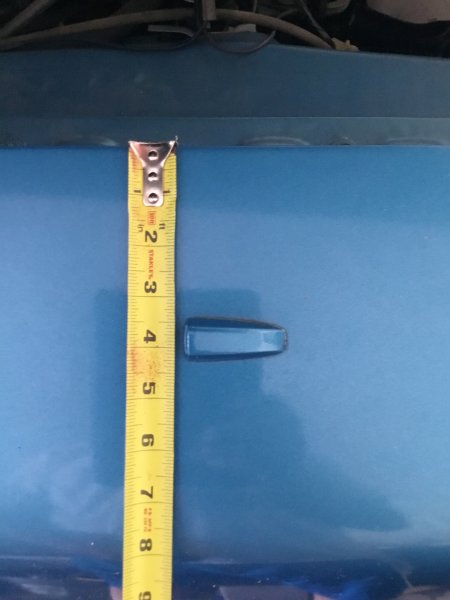

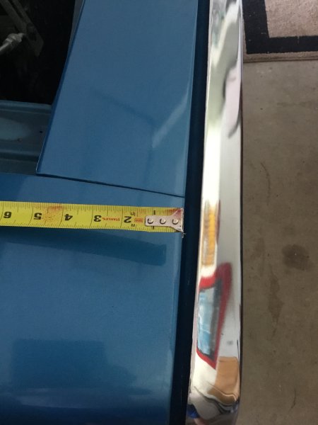

I'm close to paint on my 71 Roadruner but I can't find anyone who has the measurements where the fender turn signals go. Would anyone help me with location. Thanks
Mine are mounted on the hood
Yep with the standard RR hood they are in the hood. Satellite flat hood and the A/G hood they are on the fenders.
I can get the hood measurements.
Yep mine are going on the fenders because I have the air grabber. Thanks for any help.
Hope this helps. RF fender came from 71 SSP.
Thank you very much. This is what I needed, Have a great day.
