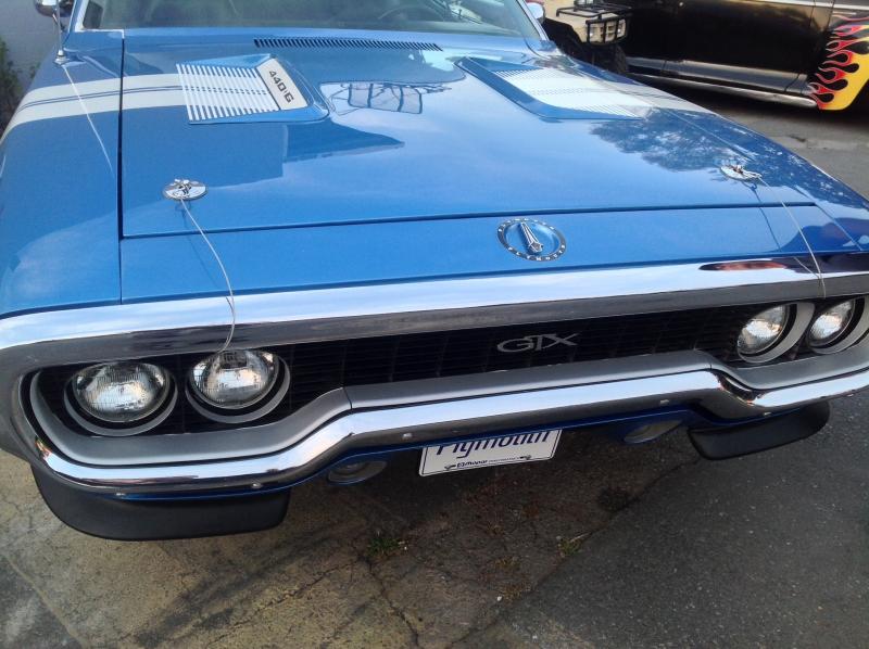

image.jpgLove the 71's. The "triple-nipple"equipment sounds really appealing. Gotta get one.
