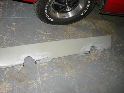

A member 72RoadrunnerGTX(?) did this years ago If I remember right. AMD might be out of stock, just like everyone else for even the simple small pieces, but is worth the wait too

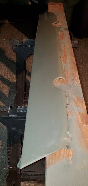

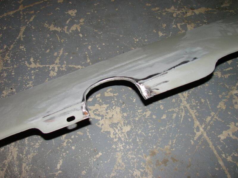

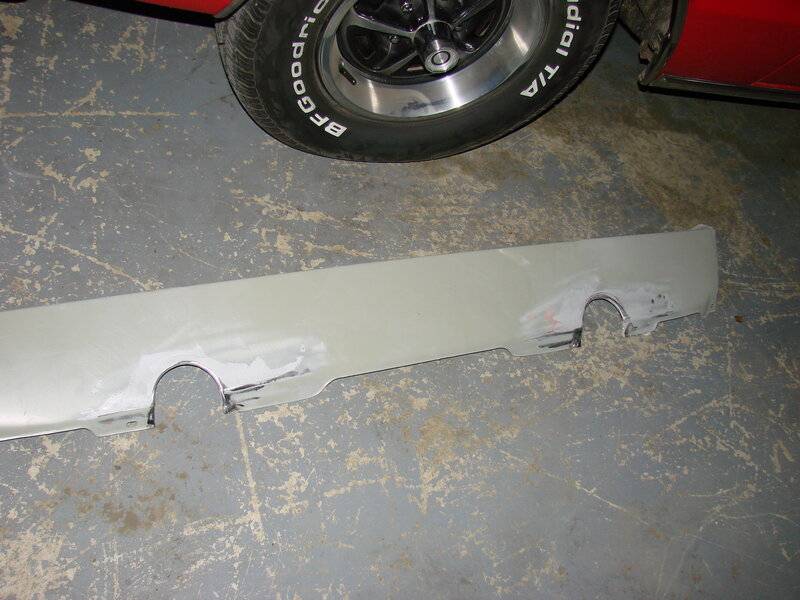

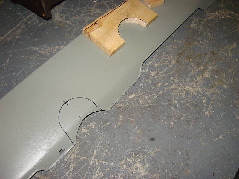

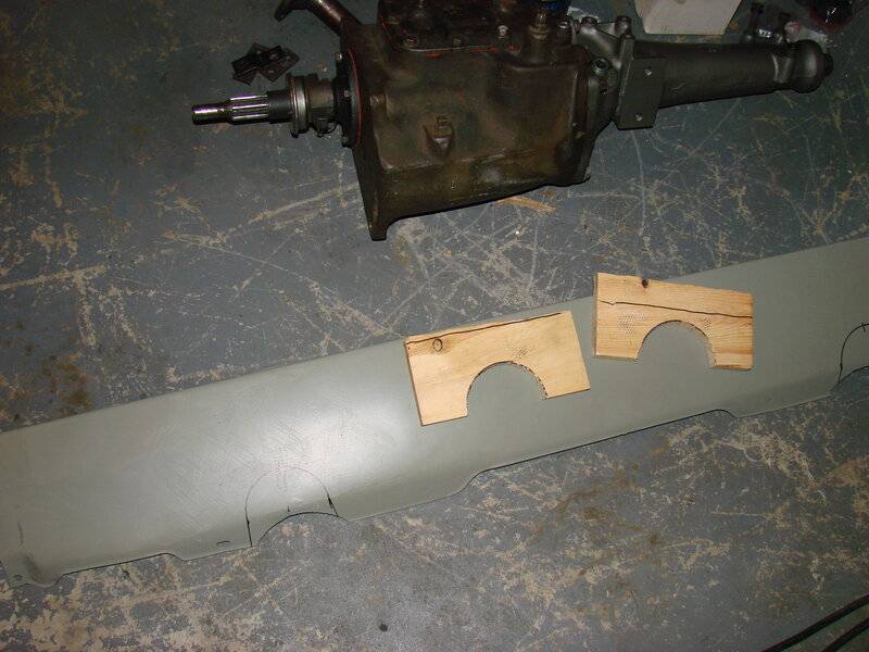

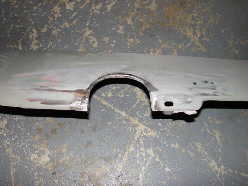

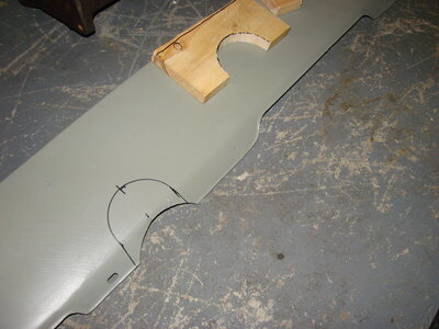

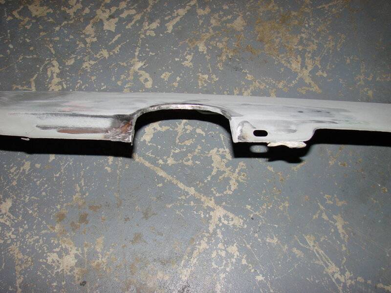

I made some wooden bucks and hammered the lips over. I thought I had one with the measurements but can't find it.
650hpproject 003.jpg DSC00235.JPG DSC00236.JPG DSC00237.JPG DSC00237.JPG DSC00238.JPG

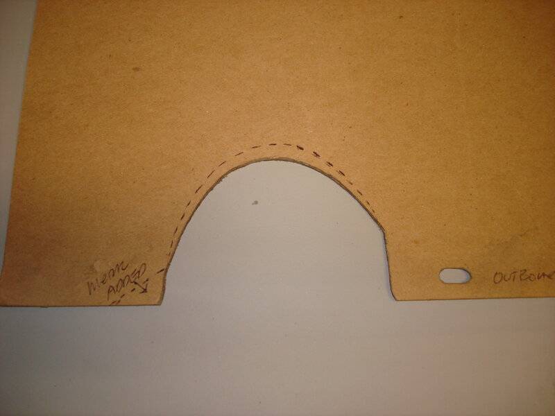

The outside buck should be concave and the inside buck convex as well. If you're not in a hurry you could also buy the decor stripes for the valance to lay over and help with placement.
It's been probably 15 years but my foggy memory recalls having to add a small pie shaped piece of sheetmetal along the bottom lip one at least 1 side. Kind of a fun project actually.

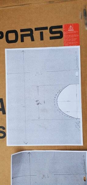

Yea, fairly easy mod. Simple slight inward fold and adding a small piece to make an accurate copy of the factory cut-outs. Pm me if interested in a scale correct copy of the pictured template used, traced from an original.
Assuming the dotted lines are for the fold.
Thanks to 72RoadrunnerGTX,

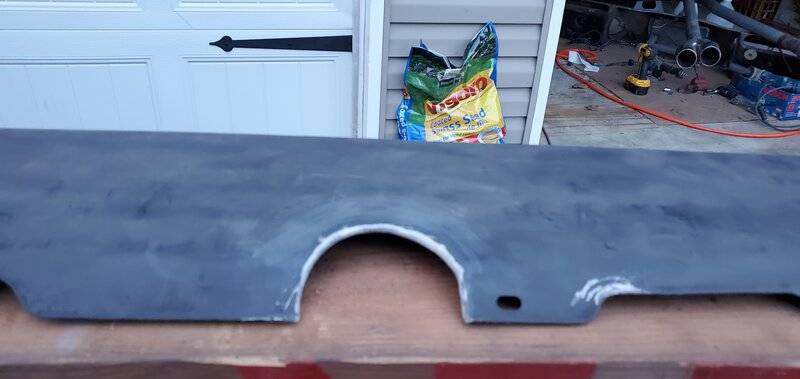

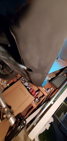

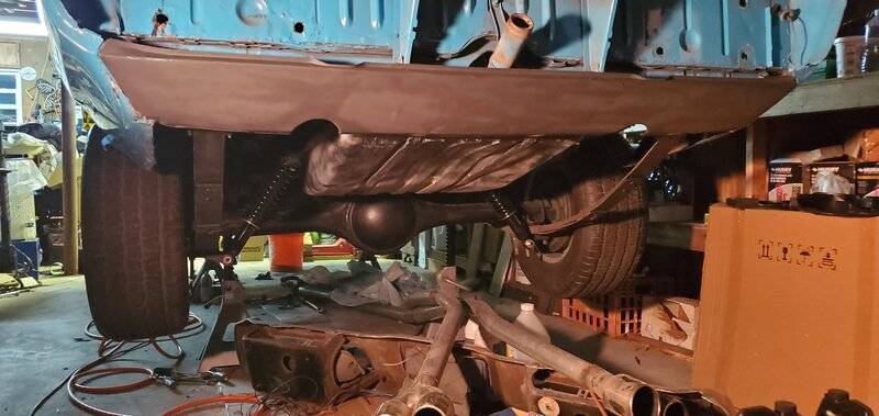

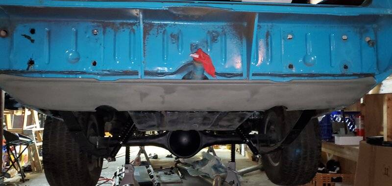

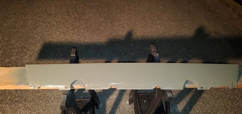

I was able to get started on the valance.
I spent about 2 hours so far, and was able to get them roughed in.
Thanks again, you just saved me months more of waiting in AMD, and a fist full of money!
Looks good! 72 RRGTX is a wealth of info

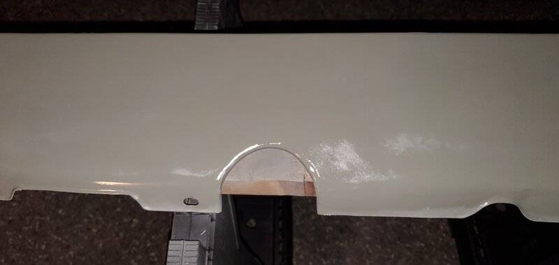

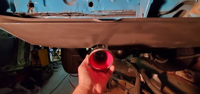

Finished working the cutouts.
Just need to finish straightening her out just a bit more.
