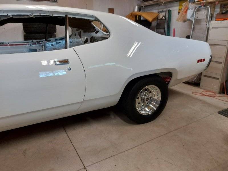

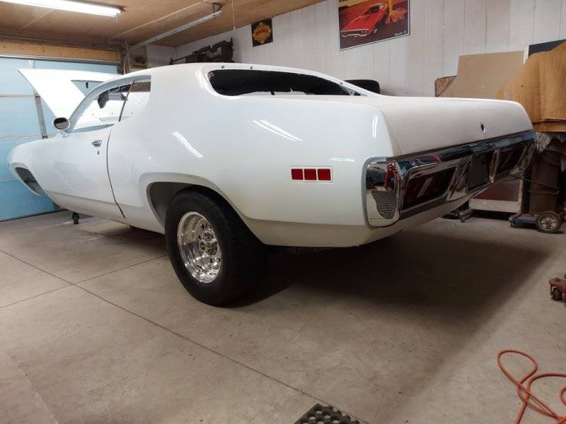

My Runner has an 8 3/4 rear with the 1 1/2" offset for the leaf springs.
I have an 8" Weld drag lite rim with a 275-60-15 tire with plenty of room on the inside.
If your springs are in the stock location, you can use a 7" wide ralley rim (if you can find them) with the same size tire I have, but you will have a bit more bulge on them.
