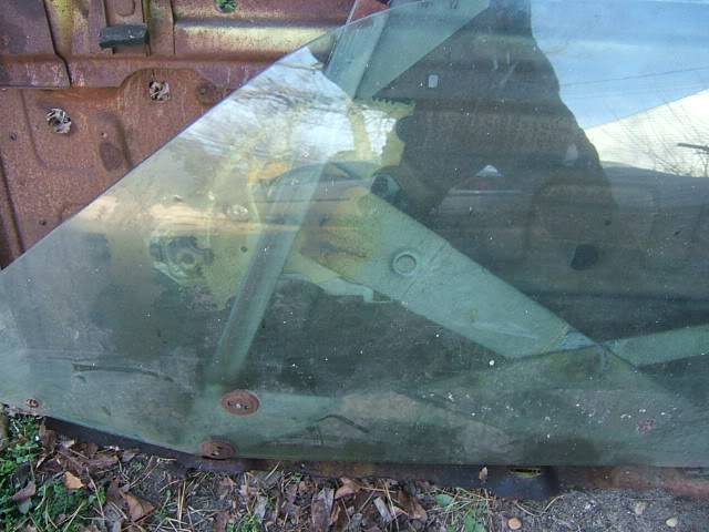

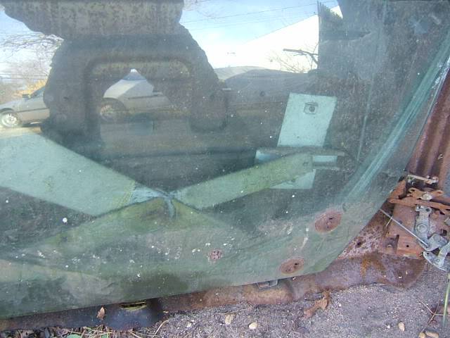

71 doors....
i just gutted 5 of then not long ago
the secret to them is you need to unbolt the glass
from the track to be able to get them out of the shell.
the area of the door that has the most problems is right there.
either the screws that hold the glass falls out and something
else was put in there over time or
the screws are rusted solid and you will have a
battle with it..

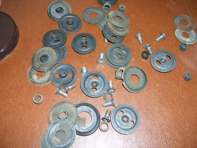

these pics might help
they are with the door shell cut away
Like Frank says the key is getting out the 4 screws that hold the glass into the regulator. If you can its a piece of cake. If not then you pretty much have to un-bolt the regulator and wiggle everthing apart.
Also remove the rubber end boots and the 2ea giudes and stops at the top on the door. Also the 2ea. roller giudes and plastic bump stops on the glass.
Thanks for the advice! Flypaper-thanks for the photos. I least have some what of an idea what is waiting for me.
