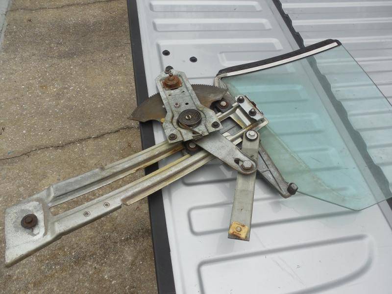

Anyone have photos of a complete installation for the side windows. I bought this car and all the parts were in coffee cans.
I have looked at the service manual for the 71 page 6-23 but, just not very descriptive. I think I have all the parts but am looking for photos how the stabilizer channel fits on the glass itself. I have purchased the restoration kit just need a little visual assistance on how the fasteners fit on the windows and which ones to use.
I appreciate all the assistance you can offer. Bad 505
Don't have pics of this rear window installed. There is another piece (channel) that bolts to inside, inner wall of car that the white plastic goes to.
If you can't find that piece in the cans. there is a possibility that the previous owner didn't take it out.

The kit however only had two rollers for each regulator. I called them and they sent out the additional two rollers. They had me take photos of the regulators to correct future kits.
Just FWI- MANY aftermarket kits are not accurate. If you're talking about a roller that helps move the window up and down, then I won't be surprised if the aftermarket kit isn't complete. Look at the picture wayha posted. The square block is mainly used in front and 1/4 to roll window up in channel.
