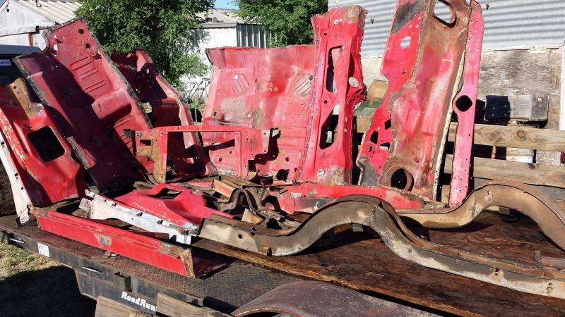

Hi All - I have a new (customer) project and I'm not sure what interchanges... 1971 Super bee - I thought the whole front end was the same as an E body - meaning firewall, cowl cap, inner fenders, rails, etc were the same. Can the pros verify what's actually the same?
Cowl tops are different
A/C fire walls are the same but non-A/C fire walls are different.
Front frames, core support and inner fenders are the same.
Are these new parts or recycled? Also looking for the flat areas of the rear seat pan.
I only sell original Mopar metal from the Southwestern Desert. All drilled at spot welds.
No China **** here.
