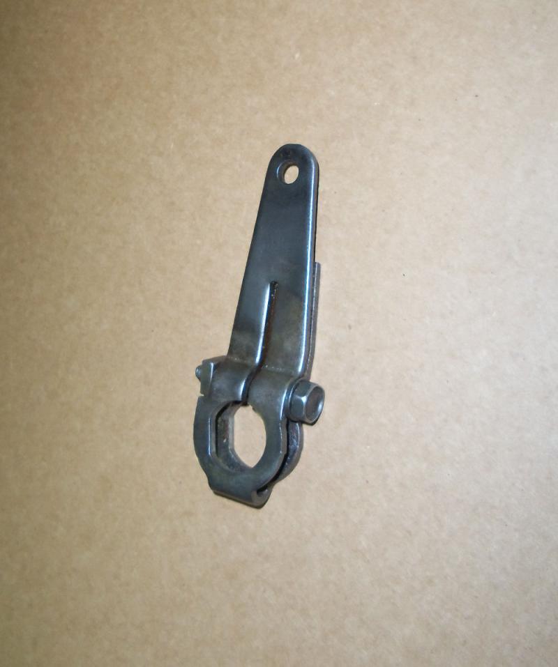

70 e-body parts do not interchange correctly or mix with some of the 71-74 E & B-Body console automatic parts, maybe that is what happened. If you suppy pics of what you have we should be able to help you figure it out. Part number for the lever is 2801828 and here is a pic, if you need one i have them available PM me
