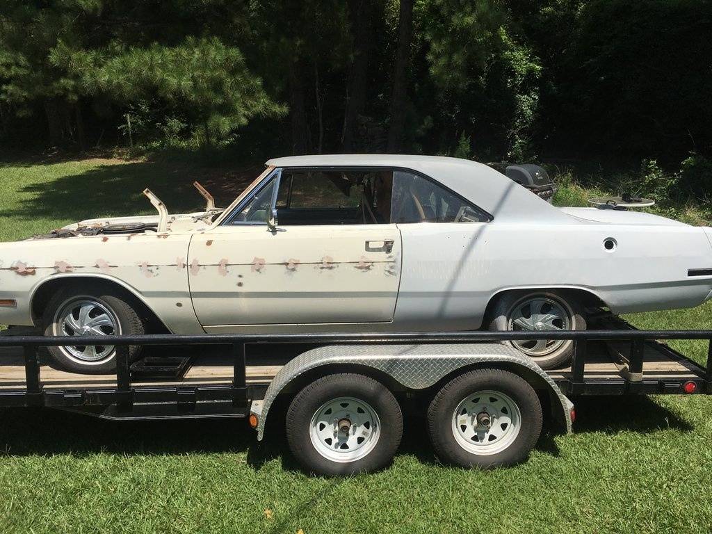

Hi guys I just inherited a new project to add to a list of things to do.
It is a 1970 Dart with front drum brakes. I have a 72 charger parts car and was wondering if I could swap the disk brakes over to the Dart.
I haven't done any measuring jut based on looks alone the control arms seem to be the same.
Input and advise is appreciated as I am fairly new to the older mopars.
