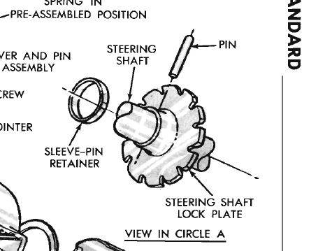

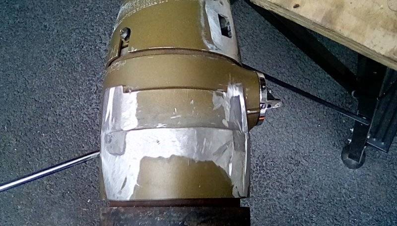

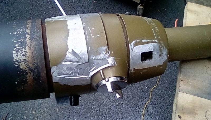

There is a plate with grooves cut into it inside the upper housing that is fixed to the shaft. I inspected it to see if it was stationary or if it could be removed. I see a snap ring and circlip but I don't think that is what is holding it on.
There is a sleeve around the lock plate mount, pry it up to reveal a roll in, knock out the pin, lock plate comes off.

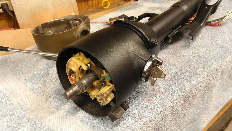

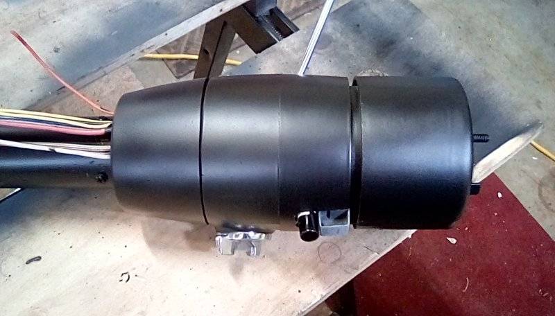

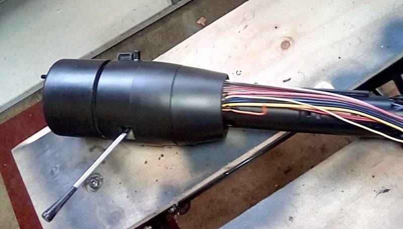

task complete. Steering column has been converted to a floor shift column. It was easier once I reviewed the assembly diagram. Removing the pin securing the lock plate made it simplified.

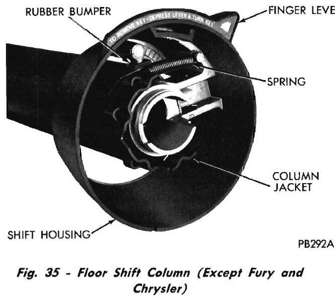

Great information! Did the new collar come with the spring for the finger lever?
I did this conversion.
I was unable to source that spring.
