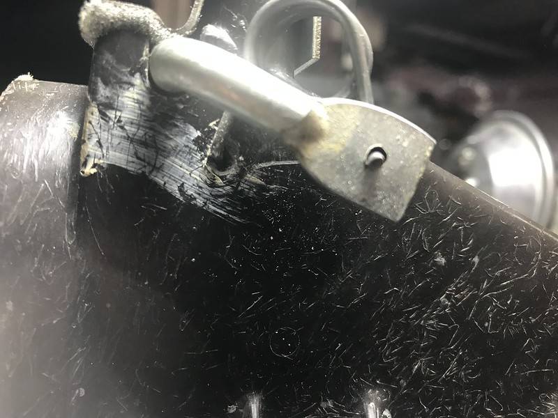

I rebuilt my air box on a 72 charger SE with A/C. The spring for the fresh air door is
Worn out into a large slot. Can somebody post a pic of correct hole placement for the spring, so I can repair and install correctly.
thanks in advance Moparians!
Not the spring, in the housing the spring wore a slot into it. If I can get a pic of where the hole should be, I will repair with fiber glass

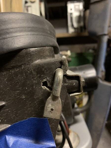

I'm rebuilding mine right now, is this what you are looking for?
If it is I can get you a better pic.
That’s it. The hole in the fiberglass housing is worn excessively. If I can get a picture of where the hole Should be. I can repair with fiberglass and maybe a small plate imbedded with a hole. I will then post my repair.

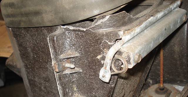

Yeah my other two boxes looked similar, I did a lot of cutting and filling with JB Weld and spare heater box material.
Good luck with it.
