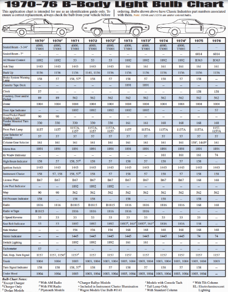

does anyone know what the bulb # or size is for fender mount turn signals on a 72 charger ?
Can’t remember the number. It’s in the owners manual (online)
330… same than 2nd gen Charger hood bulbs
