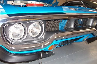

If the bumper is already on with the brackets installed. The mesh screen is first then the center grille section must go in as the headlight bezels notch over the center. Then the headlamp shields, then the headlamp buckets and your done.

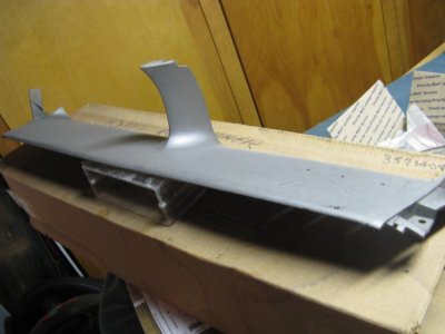

What center grille section?
Grill mesh, center and H/L bezels.
You are refuring to the filler between the headlamp bezels, bumper and screen?
Yes that is the grille center....
Here is an nos one I have so you know what I am talking about...You can see where the headlamp bezels clip into it along the bottom..
I need to get the RR cleaned off again could not remember the center post being there.
Am not sure of the correct color but they were all the same regardless of body color.
