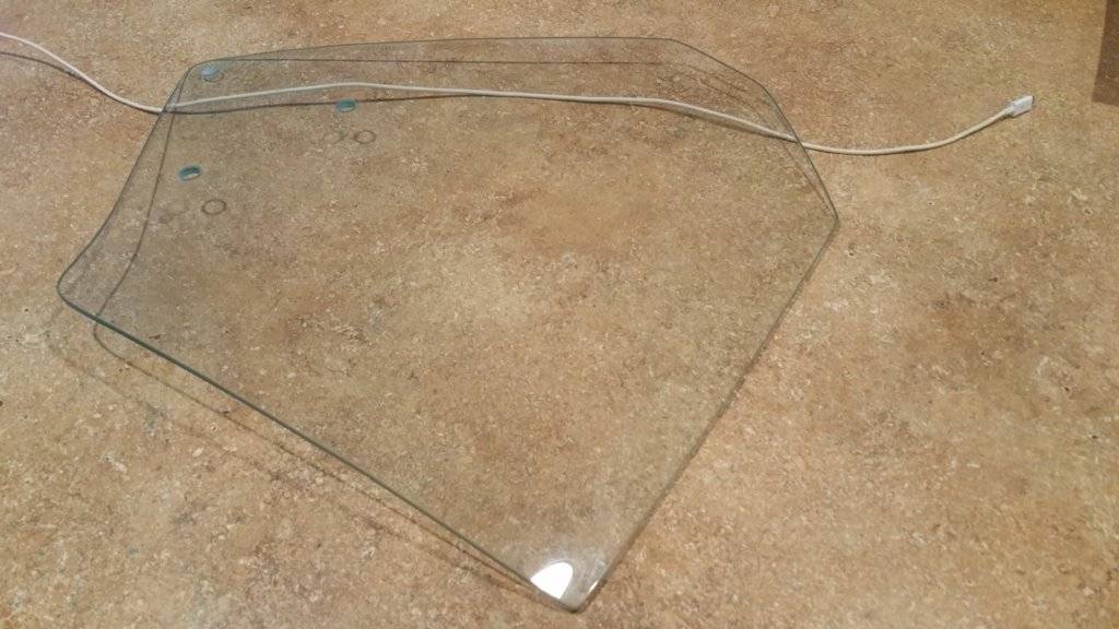

This may be widely known or it always has been but there is now 72 rear quarter glass being reproduced. For the past year I have been looking for glass but only found everyone to carry only 71 models only which is different than the 72. I found a place online called metro parts market that had 72 for sale. It's a bit pricey but they quality is top notch in my opinion. Matches my old glass exactly.
I figured I would share this for anyone who might be looking for new 72 glass.

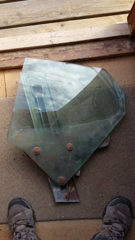

I am trying to find a picture of the 71 glass as I don't have it but it has to do with where the holes are. The internal mechanisms are different between the 2 years.

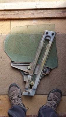

Here is my 72 glass.

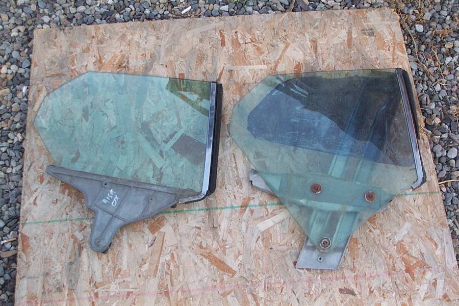

i think, that pic confirms ( per what I recall ) the 72 Plymouth glass could be the same than 73/74 Charger

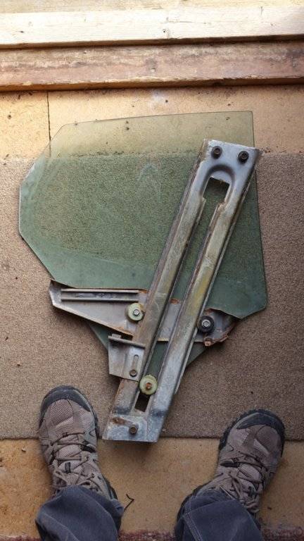

Well I guess I'll snap some pics of my 73 Charger quarter window assembly, so we can compare the pictures. Will post them later
Here a few pictures of my driver side quarter window.

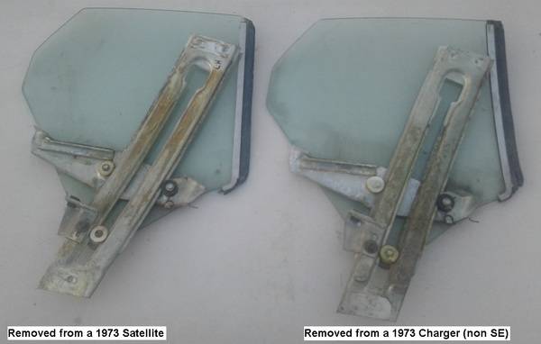

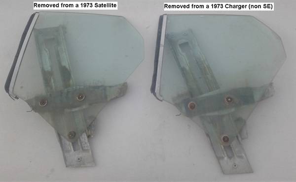

I will add my 2¢ here.
Below are pics of quarter glass with their associated tracks & glass brackets. One was removed from a 1973 Charger and the other was removed from a 1973 Satellite. And they both look the same. And according to moparmarks pic above they look the same as a 1972 Plymouth. So do we have 1972-74 Plymouth and 1973-74 Chargers all being the same?? Keep in mind these would be only the models with roll down windows and not fixed glass.
The two pics attached are each side for each window.
Thanks
ok so this gets a WIDER selection... not just 72 Plymouth but all 72/74 againts 73/74 Charger

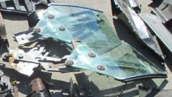

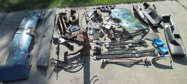

Now it looks like 72 Chargers are in the mix. I seen this craigslist ad for a 1972 Charger rallye:
https://ocala.craigslist.org/cto/d/1972-dodge-charger-rallye/6339657937.html
There's a pic of some of the parts that are included in the sale. In that pic you'll see both quarter windows, not up close but they do look like the ones that I posted.
Here's the pic from that ad.
Here's a blow up of the same pic.
