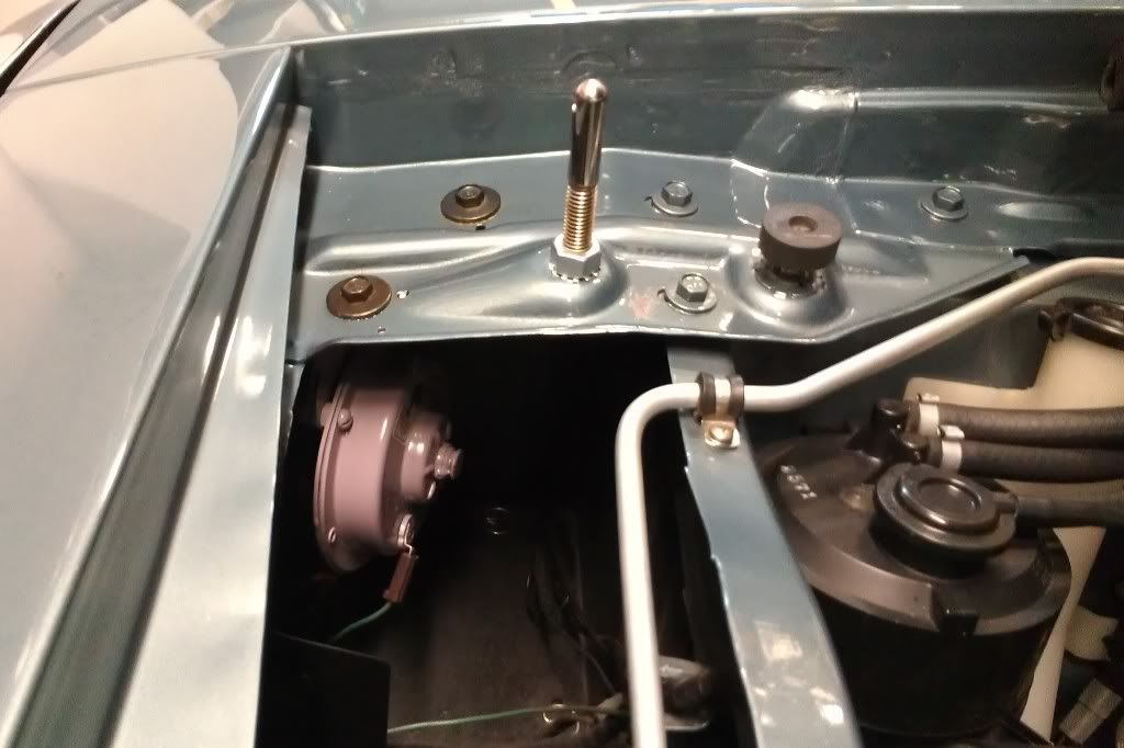

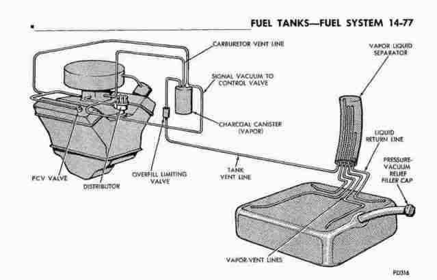

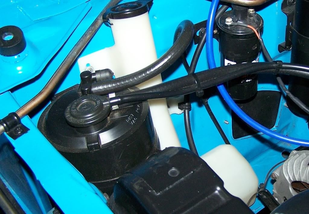

Here is a picture of what it looked like.
I believe this is for a 73 but the one i had looked like it and when it got knocked off the shelf, A bunch of coal looking stuff came out the bottom of it. It very well could not be for my car but I wanted to check. My brother said that if I ran more power and a mild cam that I may have trouble with my power brakes due to a lack of vacuum so I wanted to get feed back. I remember my 73 had one of these up on the front passenger side but never on a 72. Thanks for the feedback.
That’s a charcoal canister, part of the evaporative recovery system, yes it’s full of charcoal particles. Has nothing to do with engine vacuum and or power brakes. Of the two pictures you posted the 4 nipple version is correct for ’72, 3-nipple version is ’73 and up. Only high over-lap cams (more radical) can create vacuum issues for power brakes, most mild cams don’t require adding vacuum pumps.
Awesome Thanks! Now I know my car is supposed to have one. In the picture with the one attached, is that where it goes? Is it imperative that I have one or are there other alternatives? Heck, mine has had one on it since 1996. As far as the brakes go, that is what I thought, I don't plan on doing any thing crazy with the cam. I am looking at trying to get 450-500 ponies with a very mild cam set up. I plan on driving the car a lot so I want it to be easily streetable. Thanks a million!
