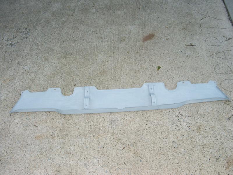

And I just looked at the valances I have and they use different mounting brackets also.

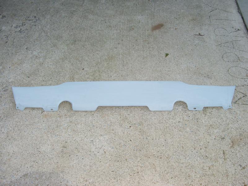

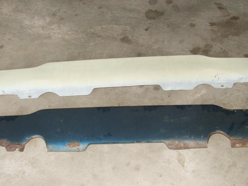

Here is a pic of the tops showing how the 71 is straight across and the 72 sticks up in the middle and also of a pic of tip VS non tip valance
Those are some good, clear picts of the valances and my idea of grafting the top, middle of the 72 val onto the 71 will not work because of the differences in the mounting brackets on the 71 val. The 72 valance you show looks new, where did you find a new 72 valance?
I actually have 2 NOS 72 rear valances, I have had them for years now.

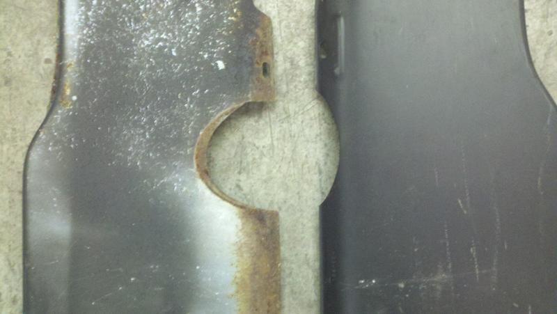

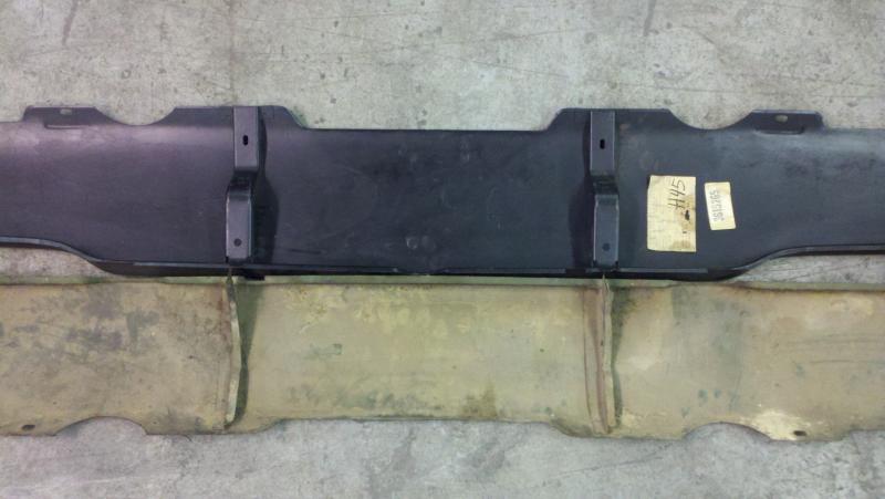

another thought is to have your 72 valance opened up for the tips this is what i have done.i had a original tip valance(very rusty) and a non tip valance.heres the results.
Nice-looking job.
I've got a '71 rear dual cutout that I can't unload thanks to the aftermarket. :(
Sadly, I'm keeping the '72 rear end, so I'll have to follow your lead, unless AMD pops out a '72.
1972 roadrunner rear lower valance
called amd before i did this.they said there are no plans reproduce the 72 rear valance.
