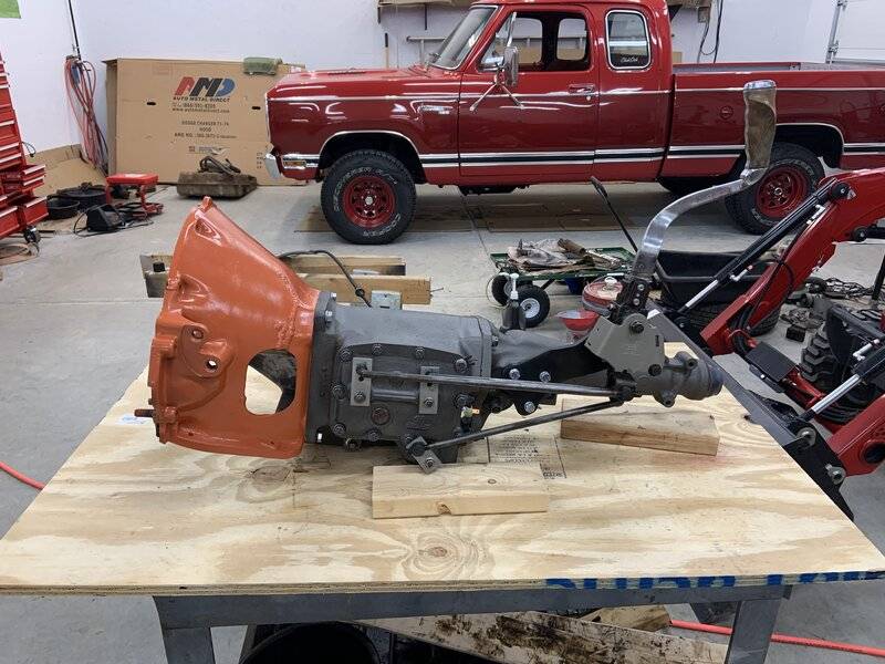

Here is a pic of the forward shifter setup. Your early trans with the forward mount will work. You will need the dog bone, correct shifter and rods. A shifter handle with a ball that sweeps back should work just fine. I prefer the pistol grip.
Good pic of a complete ‘71-74 B body bench set up! :)

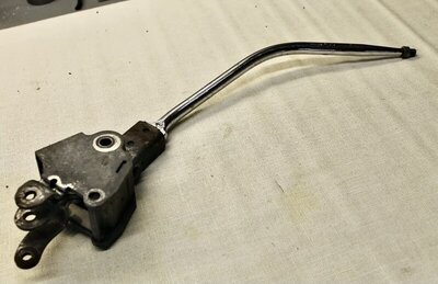

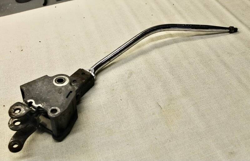

Super, super useful information. I’m so glad I joined this site. I guess I’ll return the unopened installation kit and get the correct stuff from Brewer’s. Would a regular ‘68 to ‘70 B body non-console shifter like the one pictured work fine with the dog bone setup?
That’s the same shifter assembly that’s in my 69 Road Runner. It may be too tall, but it looks like it may work.

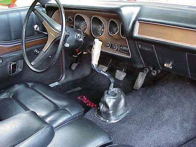

Here’s a pic of what the standard 72 b body bench set up looks like. Underneath the boot area is about where the shifter base sits, at least most of it anyways. You can kinda see where that 69 shifter would end up being.
