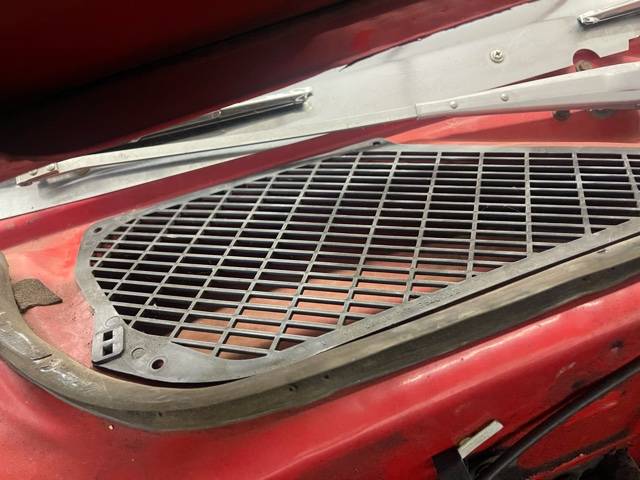

My passenger side wiper pivot is shot. I'm trying to figure out how to get at it. I'm thinking I have to pull the wiper motor so I can get the linkage to move to the open area in the cowl where I can get at it. Also, anyone know where I could get the push pin clips for this cowl cover? Drivers side has both, pax side has none.
Thanks,
Mark
Disconnect the wiper motor bell crank at the motor, leave the motor in place, remove both pivots and links as a unit. Service as needed, reinstall. Most '72s don't run fasteners on the grills, older models will have screws in addition to the clip in retainers built into the grills.
