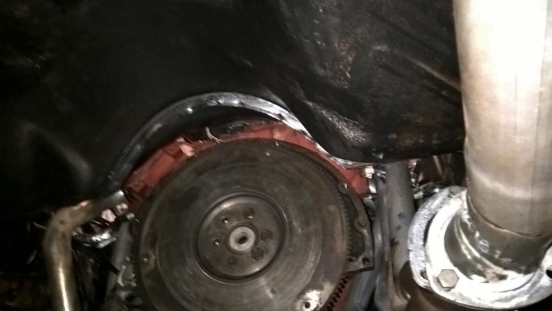

Well I was able to get the transmission out after getting the flex plate unbolted and a little prying. I tapped in the pilot bearing and attached the flywheel. I tried to use the bolts from the flex plate but they are a tad too short. I am going to have to pick up some longer bolts. This is what it looks like so far.
I wish I would have read this before putting in the pilot bearing. The pilot bearing I was sent was an adapter bearing so maybe it is a little different than the regular one?
