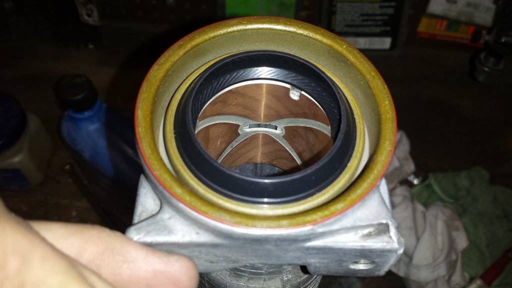

Yep, 12 o'clock. Picture of mine installed.
