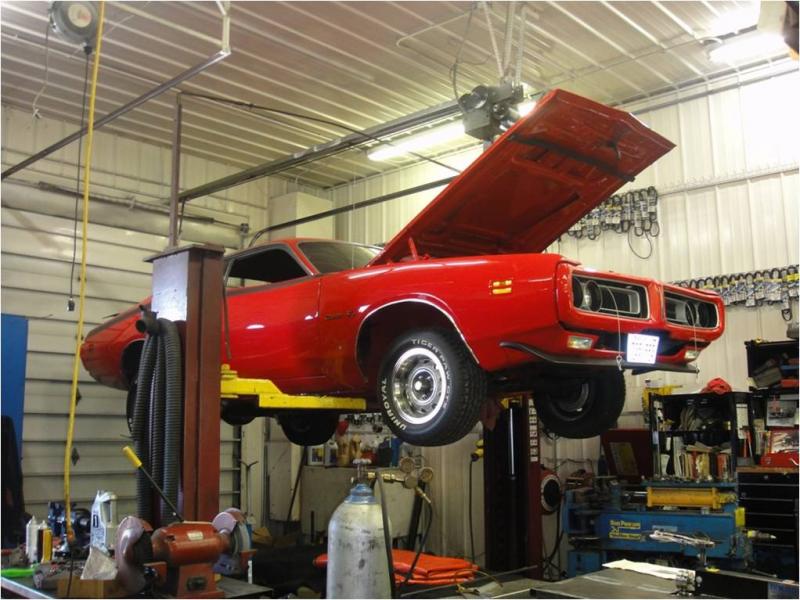

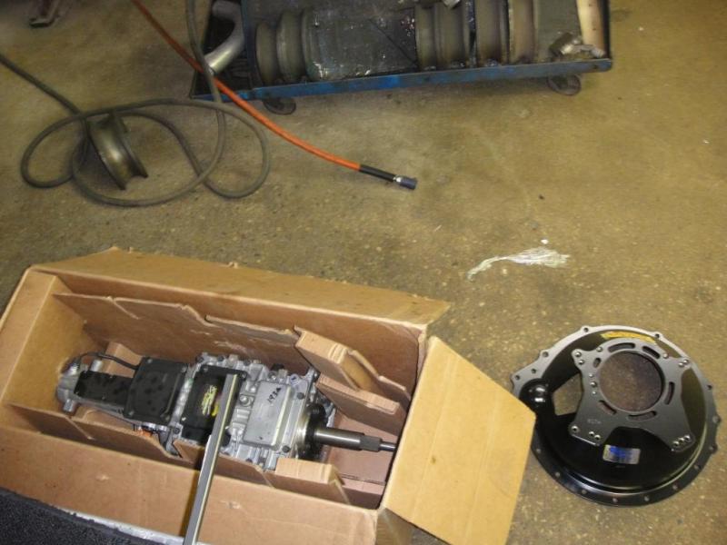

The Charger I bought did the same thing. First thought "Oh ****, What piece of crap did I buy?" I checked with some people and was told the same thing as they said above. I fixed the problem by sticking a Tremic 5 speed into it - That fixed the problem! - LOL!

Cool swap

I put the 5 speed in because I wanted a stick shift - not to fix the 727...
...and it was on the plus side when completed. But now I have a stick shift which I always wanted.
