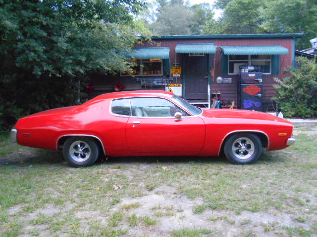

I HAVE A 73 SSP WITH A 440 AND 727 TRANS THE TRAnS SLIPS FROM 1st TO 2nd SO I GO REAL SLOW INTO 2ND GEAR THEN IT SEEMS FINE AFTER THAT, THE CAR HAS BEEN SITTING FOR A FEW YEARS, I'VE BEEN DRIVING IT FOR ABOUT 2 MONTHS A FEW DAYS HERE AND THERE, ANY HELP WILL BE GREAT. ALL NEW TO THIS

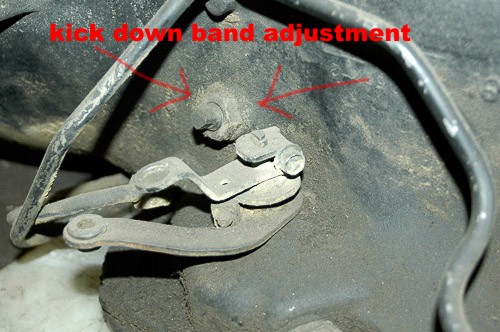

Thanks, im new to this not sure where to post question , but how do i adjust the kick down , this is my first hot rod / cool car, i have been doing a little my self mostly cosmetic, thanks again for any and all help
It's been awhile but I believe you loosen a set nut and then tighten the adjuster with a inch pound torque wrench to a certain torque. If you check out a Motor manual or other manual on 727 transmissions it should give you step by step instructions on adjusting bands. Hope this helps.
adjustment is located right behind bell on drivers side above the linkage
loosen the 3/4 nut with a open end or box wrench
tighten the bolt to 72 inch pounds ( or snug) back off 2.5 turns while holding the bolt tighten the lock nut

What these guys said, adjust the front (kickdown) band.
If it still has problems you may need to drop the transmission pan and remove the valve body to inspect the band.
