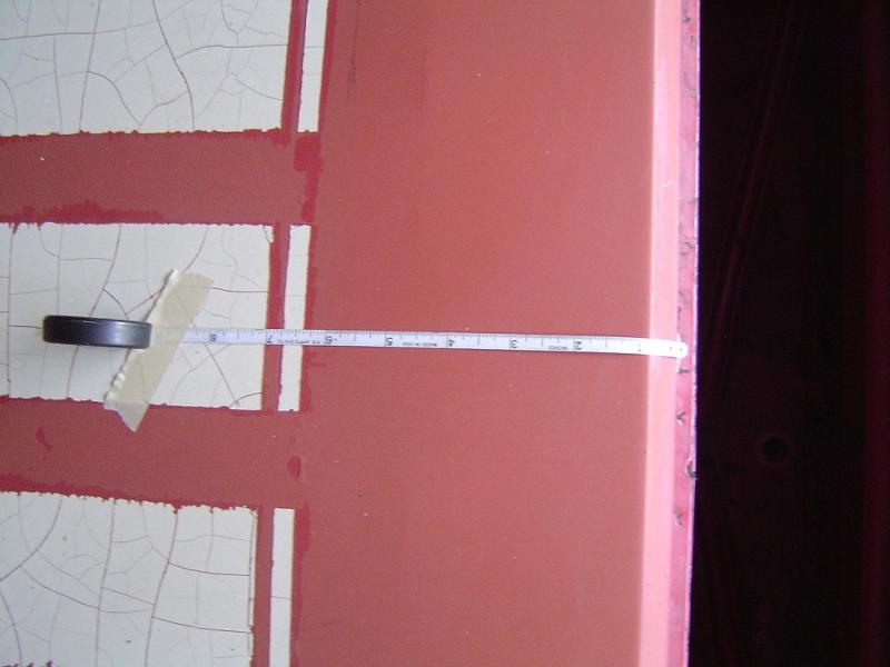

Could someone tell me what the distance is between the back edge of the roof stripe and the rear edge of the roof on a 73/74 Roadrunner? I need the measurements for the ends and the center of that part of the stripe. I always have put the roof stripe on first and then cued the rest of the stripes off that one, but I would just eyeball the location of the roof stripe. I want to get my placement more accurate this time around. :)

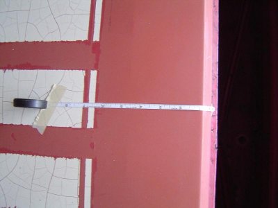

I just so happen to have a picture of that very measurement. Tape measure is from just under the window gutter edge to the stripe. 6 3/8" is what i measured. I did a bunch of different spots on the car before it left to the body shop.

Oops!!! I hope he sees this before he does it, I didn't measure mine going down the edge like this, mine just to the edge but i am off regardless... I know yours is the original so its correct, I went by pictures when i put mine on and thought i had to be close. Oh well, im still satisfied with mine anyway.
Don't worry Ron. I'll bet if we checked all the measurements we would find the guys on the line eyeballed them on most of the time and the distances vary. :)
Got that right Bruz and if it was made early on monday it could be 9.5 on one side and 5.9 on the other. Not that's not to say they may have had a few cold ones over the weekend though :angel11:
Thanks bud! i thought you may wait until someone who had one that was done right show up, and idrivemopar , his is original so you have a good handle on it.. I like the way mine look right or wrong, im not about to pay that much money again! lol.. i wasn't going to get them at first..
Although mine are factory original, the driver side is about 1/4 inch off from the passenger side by the quarter glass. Also the 340 numbers on the hood were way off, left side about an inch further back then the right side. Must have been made on a friday! LOL

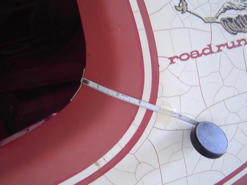

Idrivemopar you said you took a few pictures for reference before you sent the car to the body shop, would you have a picture of the area bettween the top of the roof strobe to where it gos down and curves around to run up to the front, Id like to see how much shows bettween the stripe and the rear seat window looking straight on at it? I hope im describing it correctly.. Thanks.
You mean like this?
Thats close enough! and thank you... I have to check something else but this helped!
