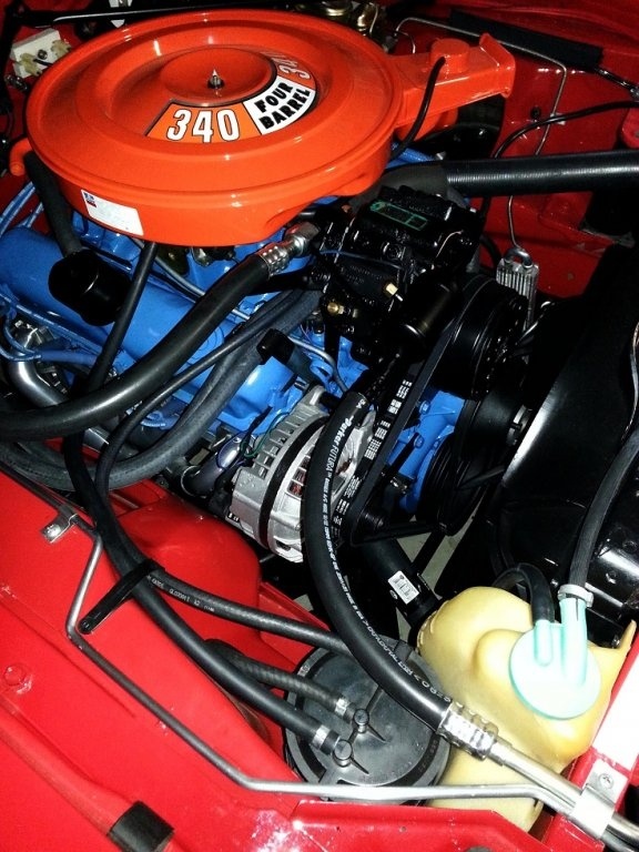

Here are some shots of my 73, I rebuilt my entire original system with just upgrade for 134a including doing the hoses because the rubber has to be changed for use with 134a.

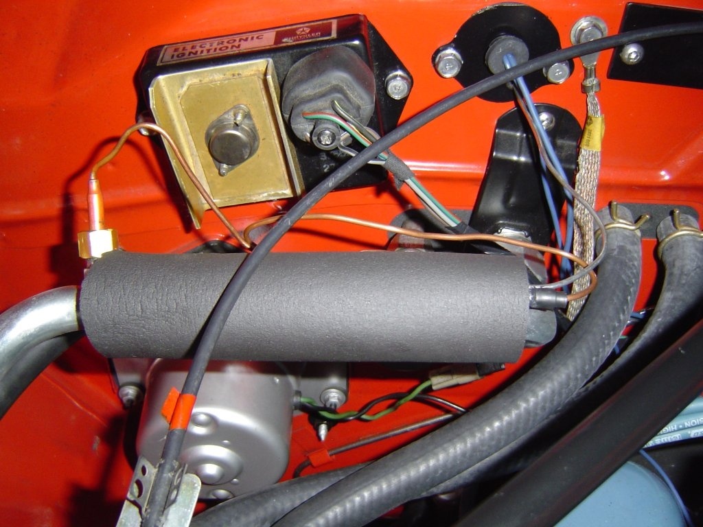

The closeup view of the pipes going into the fire wall shows the pipe with and without the insulation for the sensors.

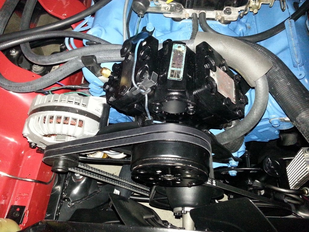

The clutch wire runs over the top of the compressor to the back side where it plugs into the blue wire coming along between the intake and the valve cover.
Here is the clutch wire route.

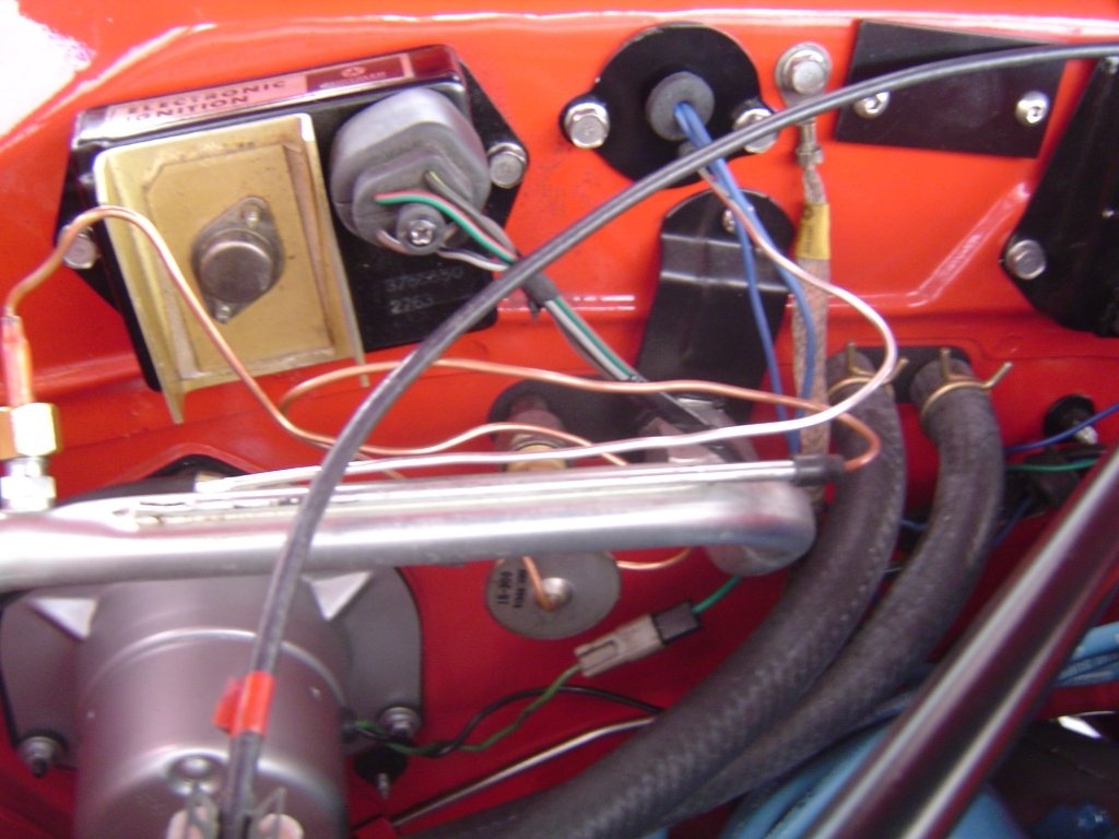

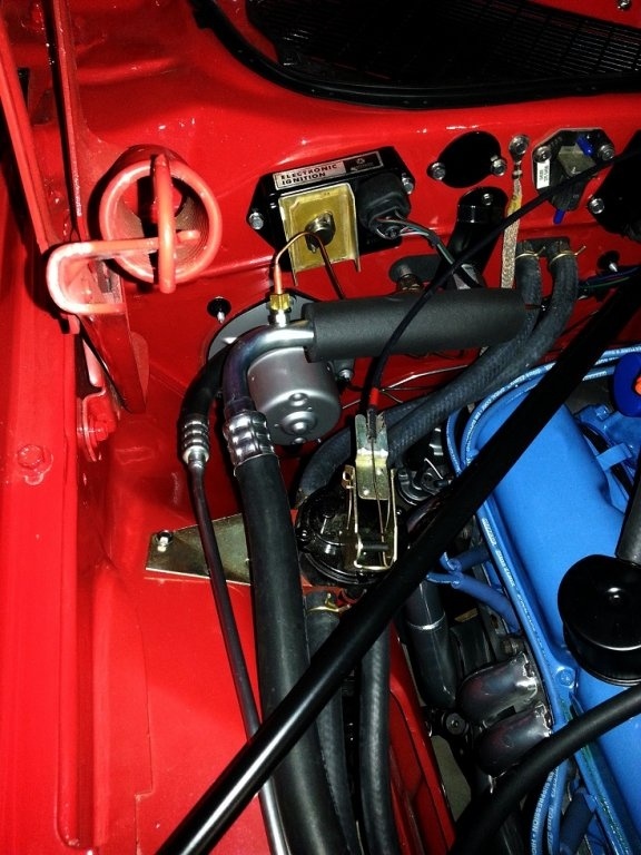

Here is a shot of the pipes going into the fire wall, and you can see the capillary for the expansion valve.

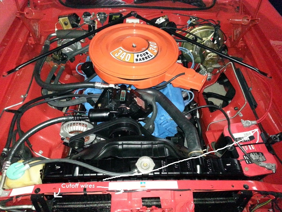

Here is a shot forward showing the routing from the compressor
Here is the wide view of the engine compartment.
Close up showing the pipes into the firewall, and the capillaries for the expansion valve and the one for the thermal cutoff which is used for 134a conversion because the EPR valve is removed from the compressor with 134a application, not done with R12.
Again showing the insulation for the capillary and temp sensor.
