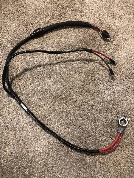

Tried digging up any other photos I could and where the hell I acquired the cable from. Unfortunately with no luck so far….
But I found the correct positive wiring by a using an older models positive cable. It had the same starter motor ends and starter relay length. Just had to rewrap the cable wiring to match the original. Also, Was lucky enough to be able to reuse the heat rap from the original cable as well. Definitely not much help at the moment but I’ll keep searching
