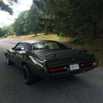

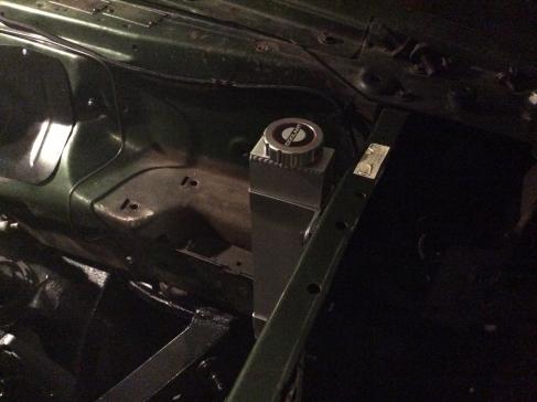

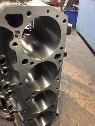

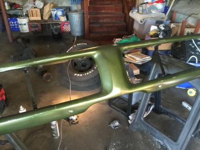

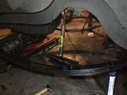

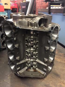

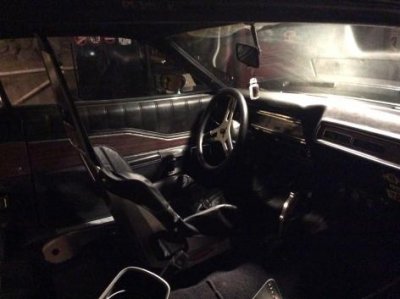

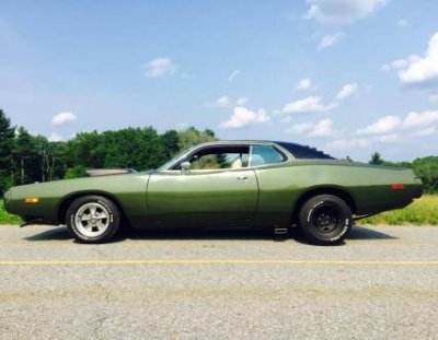

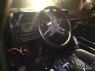

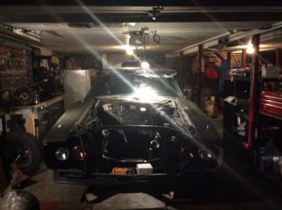

Been on this site for a while now and just recently pulled the 318/727/8 1/4 driveline from my what used to be daily driven charger. So far drivers seat has been mounted, 440 is off to the machine shop to grow in size and battery has been moved to the trunk. Installed Ss springs and waiting on ordering a Dana from moser(hopefully around the end of December.) fiberglass bumpers are on order and not sure if I want to go chrome or painted yet, but they should be here in a few weeks if not less. Then I can hopefully button up the exterior and start dumping money into the motor again.
Pictures didn't come out in the order that I wanted but the complete photos are of the car about mid summer. Anything else has been done in the past couple weeks

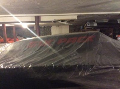

Already have the full glass six pack hood. Sticking with that, love the way it looks

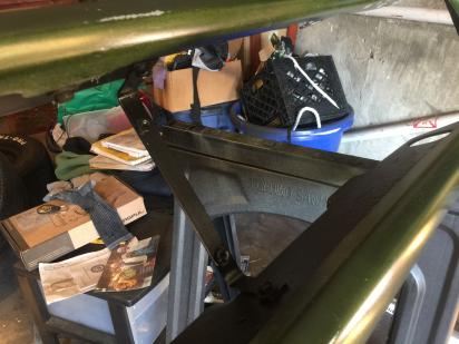

not much done since the holidays..few odds and ends, new k frame bushings installed was probably the biggest. rear drivers side was a pain in the a$$. the nut welded to the frame rail somehow broke so the bolt kept spinning and spinning. finally just drilled a big hole inside the frame rail so i could get a socket on it. should probably fix the big hole i drilled...but naturally ill wait until the car is driving and i have access to a welder. pics coming later tonight.

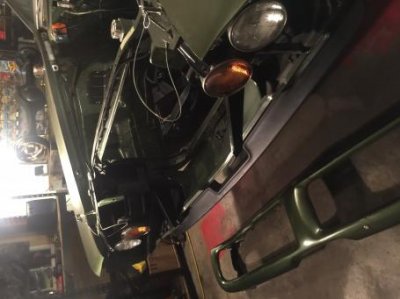

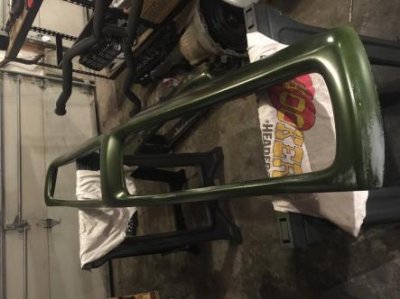

Little bit of an update..fiberglass bumpers came in today. Man do I hate painting fiberglass. Need to have the local paint store mix up a couple more cans of green so I can finish those, then install the front end. Probably a lot of shaving and cutting will have to be done. Want to flush them and eliminate the ugly filler pieces. Also picking up a console this week, then I can start tackling the audio system! Slow and steady.
Hate painting 'glass? I've never worked with it. Maybe the paintwork isn't so bad, just the prep work?
Should be a nice weight savings though? Thats something to be happy about. It isn't easy owning a cool car. You always find ways to blow money on it.
Good luck and keep the faith!
Hahaha VERY true! Maybe I should rephrase.. I am a professional painter by no means. 20 years old and I can turn a wrench, but when it comes to paint, the most professional I get it having the local place mix up a couple cans of color match, do some decent prep, and start spraying. Not sure why but the paint didn't like sticking to the fiberglass no matter how thin the coat. Now I'm not going to go blaming my tools and such, however I'm not sure if the paint and the fiberglass just don't get along or if my prep wasn't good enough....point being, the bumper looks alright and ultimately it serves a purpose. Doesn't have to be perfect. I love how light they are, however they are sort of flimsy. I opted to stick with the steel bumper brackets rather than go fiberglass for this reason. But not before shaving as much extra material as I could off of them. So it evens out. Have to get a couple more cans, and finish them up, then figure out how to get the 71 grilles to fit good because that is something that will bother me. Pics coming later tonight!

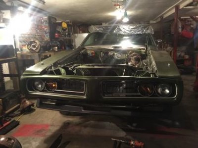

hopefully the pics worked, got everything hung super loosely so I could check general fit. Bit of trimming still needed, painting bumper tomorrow and maybe get it wrapped up by the weekend. Man I hate fiberglass, time for a shower!!

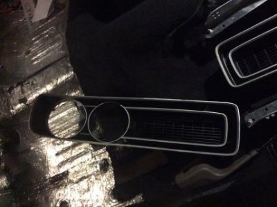

Update brackets for the 73 grilles didn't fit for the 71's at all. Made the center brackets out of some aluminum, nothing too fancy. Going to have to get creative on the outer ones. Or if anyone makes them then I'll order the correct 71 style. If not then will run with this for the time being. As long as they hold the grilles in place where I want them to sit then it's really no big issue. Oh well. Re spraying the bumper tonight and hopefully have everything mounted by tonight.
