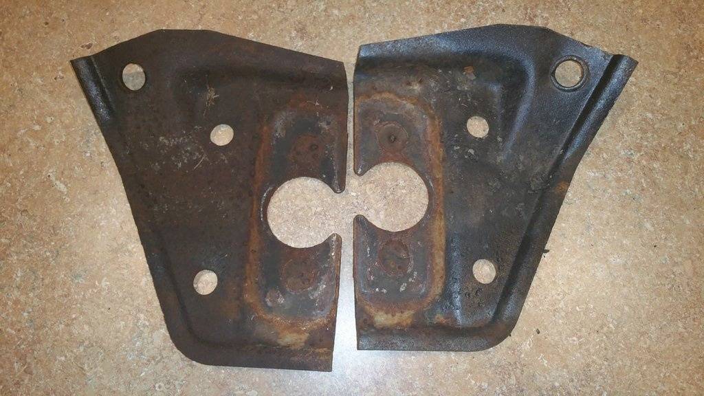

Also, if anyone has an extra plate that the links mount to (driver side), I need one. This is the plate that sits over the leaf spring. My driver side is no longer usable.

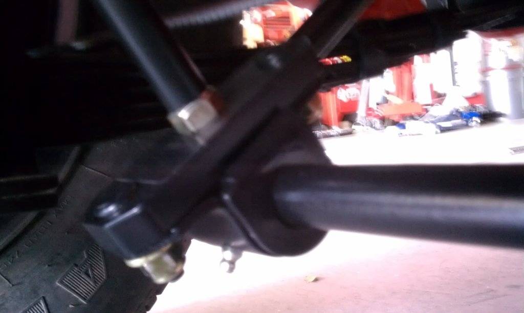

This is the kit I got from Firm Feel. I had to shim under the bushing, but other wise they work well.

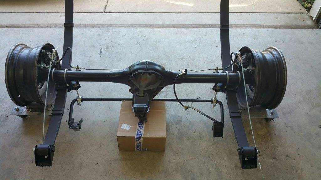

I bought this linkage set for my car and I like them a lot even though they are pricey. I could not find anyone else that made them either for our set ups. It says front but I am extremely confident it is for the back.
http://www.ebay.com/itm/331589566690
Here is a picture of it on the rear end:

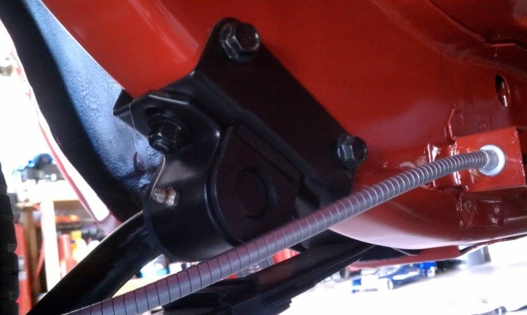

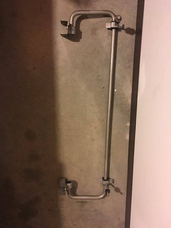

I also have a set of 73-74 rear sway bar mounts (with isolation center) that I did not end up needing since I was able to repair my 72 mount. I paid $70 shipped for both of them so I will sell them for the exact same amount. I do not have any pictures of those on my phone but can get you some tonight when I get home.
That's the 73 and lates front sway bar setup links to K frame. Somebody on the 3rd gen Charger board already used them with success as I mentioned
Thank for all the ideas, I am ordering a set of front sway bar bushings to use on the links. The search is still on for the bushings that go into the frame rail mountings. And a big "THANKS!" to plymouthman72 for parting with his set of sway bar plates! :thankyou:
