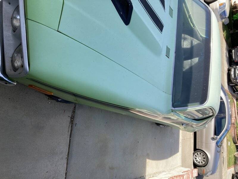

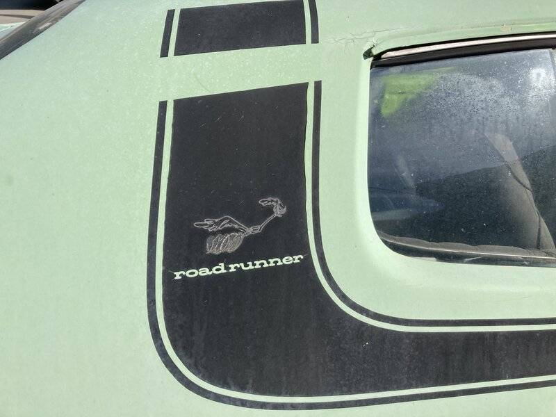

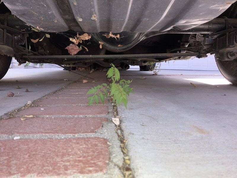

So I've seen this Road Runner for a few years and finally decided to stop and talk to the owner. Looks like he wants to sell. It has not moved and I now understand why -- see pics. Driveshaft missing for starters, open grommets on valve covers, nothing covering up carb, lots of dust and leaves everywhere, drip moldings same as body color, etc. The car does have a VIN plate that starts with RM21H3G followed by six numbers. The vin plate is cleaned off/painted silver. My biggest issue is there does not seem to be a fender tag -- it was not present.
After close inspection, it needs tons of work, but seems to be a fairly rust free CA car. Mainly wondering if it winds up being a clone, what it might be worth.
Thanks and any help is welcome!

The 5th VIN digit "H" means it's a 340 car. That strongly suggests it's a genuine Road Runner.
RM21 is a Road Runner. Maybe 5k in that condition, it could bring more in this stupid market though.

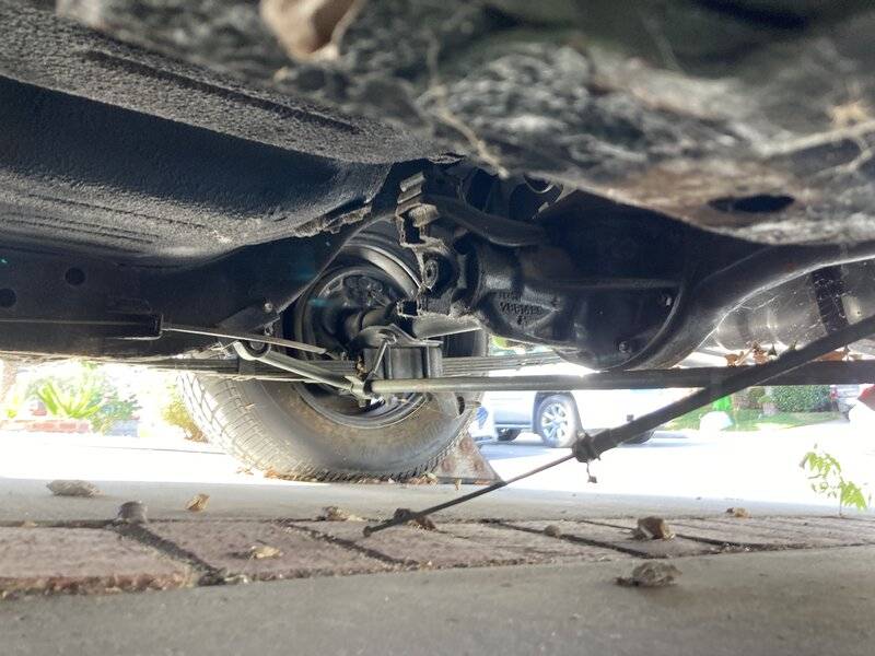

Rear sway bar, 8 3/4, nice. If the 340 is correct,another +

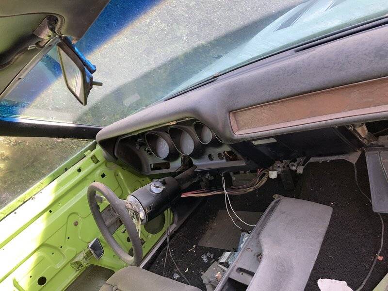

Thanks! My experience is with 68-70 RRs. Mainly worried that the dash was popped in from another car or is the suspension and everything thing else too much that it has to be a RR?
Should be body numbers stamped on the car somewhere with the year, assembly plant, and the last 6 of the VIN to match the dash with the car. I remember the E bodies had it on the cowl and trunk lip but not sure if its the same on the newer B bodies. Someone familiar with those years will have to chime in to dish out where those stampings are on a 71 and newer B body.
RM21 is a RR vin. From the few pix, I see indicators that it is so. Look on the cowl under the weatherstrip. Don't go crazy if you're thinking $$$. Go for the car if you're thinking to restore & enjoy.
4 speed car? Not many were made (956 per Google search). I don't see an air conditioning compressor...4 speed car? I don't see a trans shifter on the steering column...4 speed car?
Can you slide under the car and read the small metal tag on the differential?

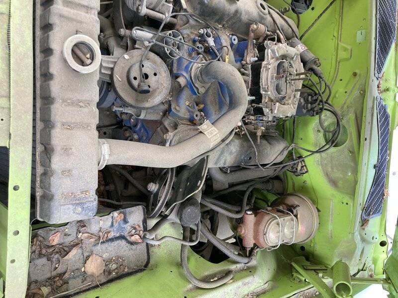

I agree on checking for cowl and rad support #s stamped in that match the dash vin. It has an aftermarket booster and GM style aftermarket master cylinder so possibly aftermarket disc brakes as well and the fuel tank looks newer.

If you are wanting a small block, auto, 73 RR.... it looks pretty decent. I would bring along a bar and see if you can turn the engine over as well as verify it is indeed a 340 and not a transplanted 318. Those two things, and if it has a clear title would greatly influence an offer.
