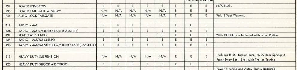

The fender tag should have a radio code. "R11" for am radio. The presents of a optional rear speaker and whether or not it has a stereo harness or mono harness(with a fader control) would provide clues as to which radio it may have come with originally.

My 74 RR has a R35 on the second data plate that is a AM/FM Multiplex Stereo radio, what does your date plate read?????
Here are the 72' radio sales codes, pretty sure 73' was similar.

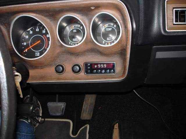

And for those interested in one person's approach to up grading one of these radios have a look here.
