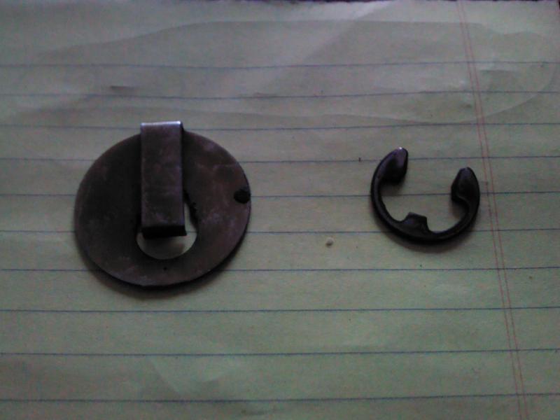

Well guys here is my most recent problem and it has to do with my wiper linkage. So the other day went on like a 3 hour cruise and it started pouring very hard. I learned 2 things my headlights are just totally insufficient and scary at times and that my wipers didn't like being on for the extended period of time. Well on the way home the passenger side wiper stopped working and upon inspection the following day all I could find was that the linkage had come apart a few pieces of old dried out plastic and two metal clips in the cowl area. Let me tell you my arm may be permanently scarred from trying to get at the linkage. So guys what do I do to fix it and prevent from happening again as I drive when its nice or raining. Here is a pic of clips I found. 1369507090847.jpg

Ok ok ok ... Hang on...the retainers/bushings are available from HELP! at most auto parts stores. I would buy a couple since they are one of the weakest parts of the system and fail just from sitting there. After saying all that .. The parts that you show are the drive arm retention clip that mounts to the end of the wiper motor shaft on satellites I believe

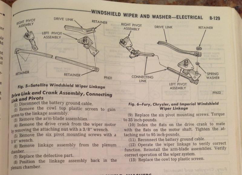

here's a picture of the linkage and their orientation. Orientation of the arms is important!

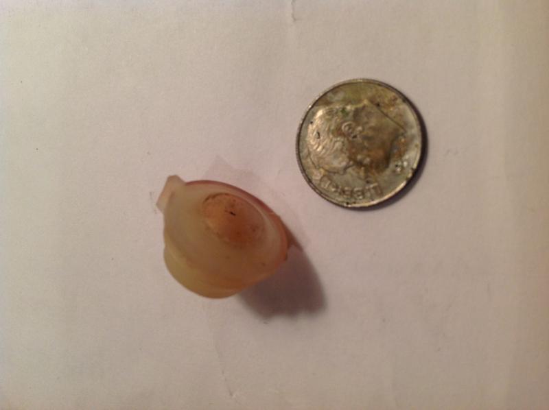

And of some of the linkage retainer/bushings. This one is trash...old and brittle.

Do these bushings snap on to the post. The piece that's gone on mine is on the drivers side and from the connection where the arm that drives right side wiper connects on the left side. The post for it is inverted so something mist hold it on and plastic piece doesn't look hollow so you can put a clip on so it must clip on some how I would think I know there is a groove in the mounting post which I assumed was for the c clip. I'll try and take some pics today of what I'm seeing as ill be giving her a bath today as its the first day with no rain in a week. Thanks

My advice is to change them all. And put them in according to the picture I posted from the FSM.
