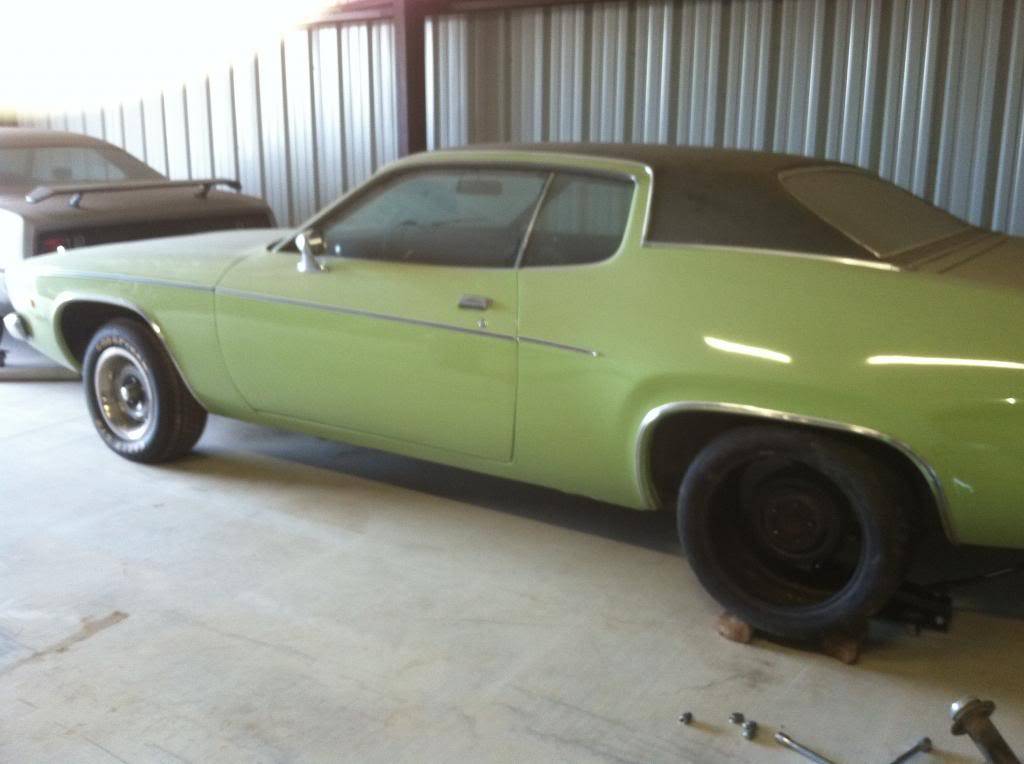

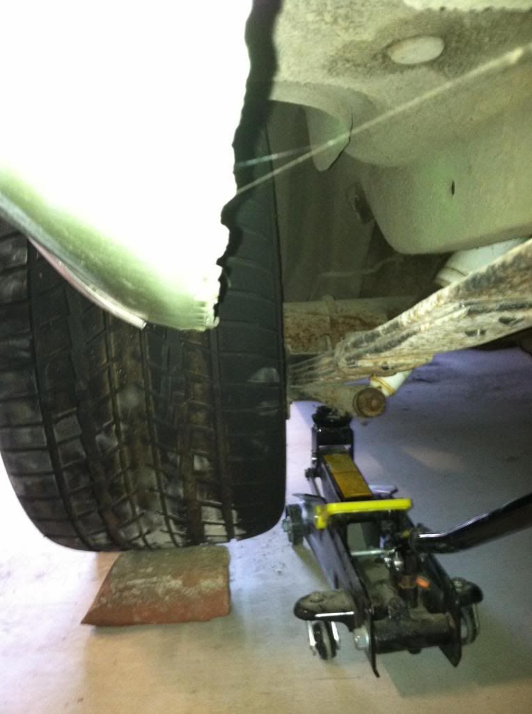

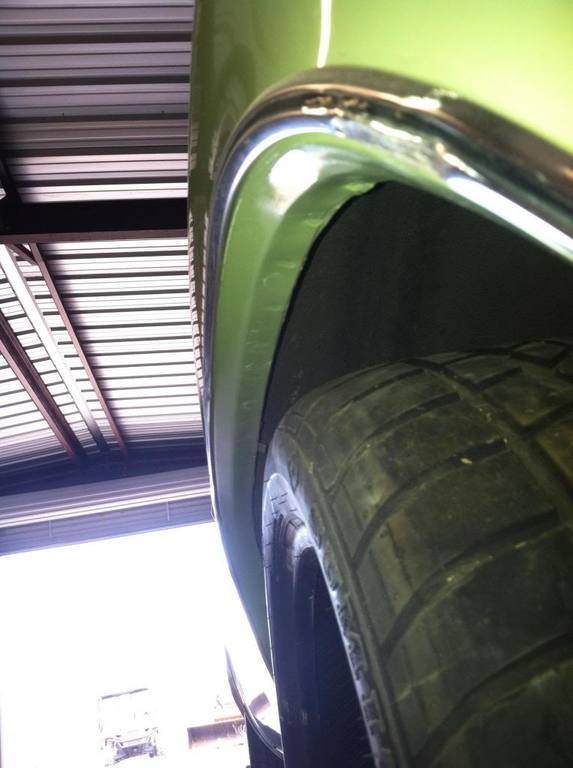

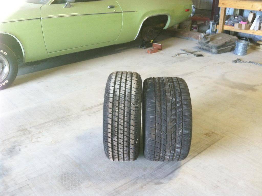

I have been cleaning out my shop and decided to mockup a 315/35/17 I had lying around. The tire is setup approximately 1/2" from springs. These pics are from my phone.
255/60/15 versus 315/35/17
As you can tell the wheel well is large enough no tubbing necessary. I'd prefer the springs were in 1" inch more, but you'd could probably get them there.
