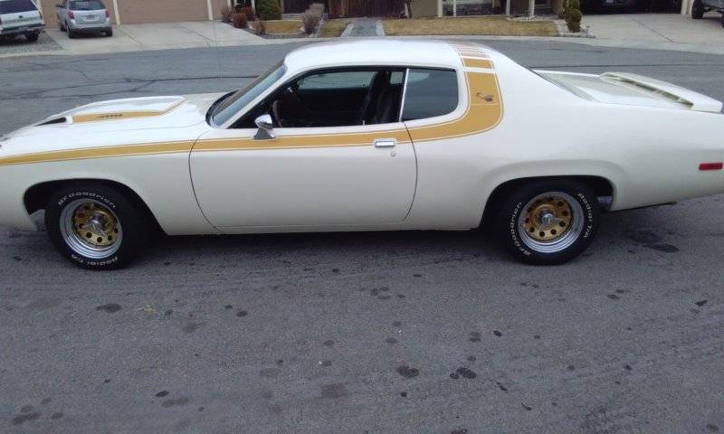

I helped my friend work on his 73 Satellite 2 door. We put 15X7 on Front and 15X8 on back, with 3 3/4 back spacing. He then changed the front so he had 15X8 all the way around.

On my 73 RR I went 15x8 both front and back with 4.5 BS.
To do it again I would do 15x8 up front and 15x10 with 5" BS. there is more than enough room.
