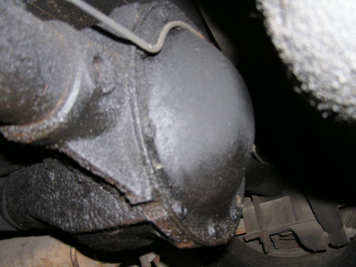

I'm looking at one (needs resto). M code (400 cu in) auto with AC.
It has a tow hitch, not sure if its factory stock or not.

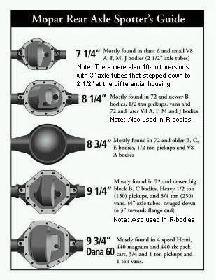

Rear looks to be a 9.25? is this normal on a tow package car?
You might check with the guys on the 1971-1974 Dodge Charger site. a lot of knowledgable guys there.
My 74 didnt have any kind of tow package but has the 9.25 rear too... with the ISO spring/shock mounts. I do not beleive 73 and 74 came with any other rear but the 9.25 but may be mistaken.
73's came with 8 1/4's, 8 3/4's or 9 1/4's.. the 9 1/4's were a late year addition as they were gearing up to replace the 8 3/4 for the 74 model run.
you have a question regarding a 3rd gen.. ask me.. i have owned a shitload of them and have tore them apart and put them back together many times :D
If the fender tag is there, look for A34 light duty or A35 heavy duty tow package. 2.71 gearing was standard on the 400 and 3.23 was an option.
Cool, I knew the 8.25 was a possibility but never seen one under a 73 or 74 Charger. And as for an 8.75 I knew they were available under a 71 & 72, I didnt know they may be under a 73 so this will widen my search for one a little thank you!
In 73 and 74 the 8.25,8,75 and the 9.25 was available. My one owner small block SE has an 8.25. I'm also just starting on a 72 big block SE that has a 8.25. Your better off paying a little more and getting a nice car that don't need much. In parts and paint it cost me over 10 grand to do my own garage kept rust free 73. If I caqn be of any help to you just message me.
I think its a 8.25 now that I look close. It an M code (400 2brl.) In a garage for 15 year. Can't get the hood up, stuck closed.

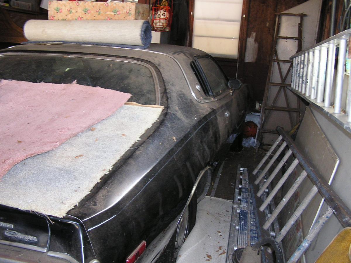

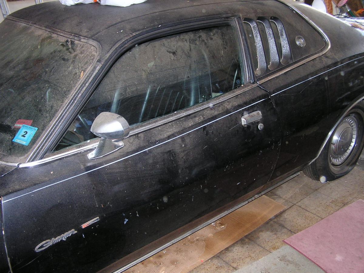

Tripple black 400 with a/c.
I'll take it!

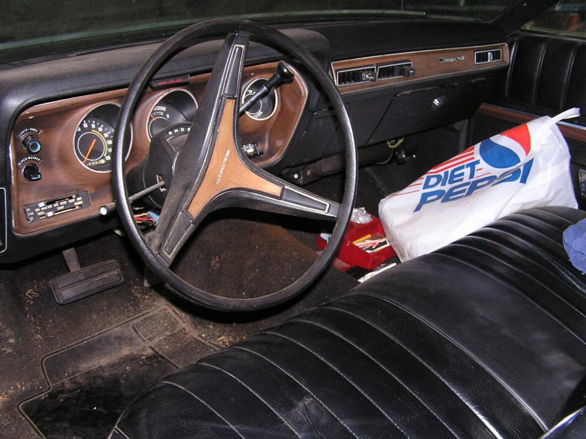

I see the 1995 NJ inspection sticker. Where are you located? Im in Morris County.
Anyway, nice car. It looks like a nice time capsule.
