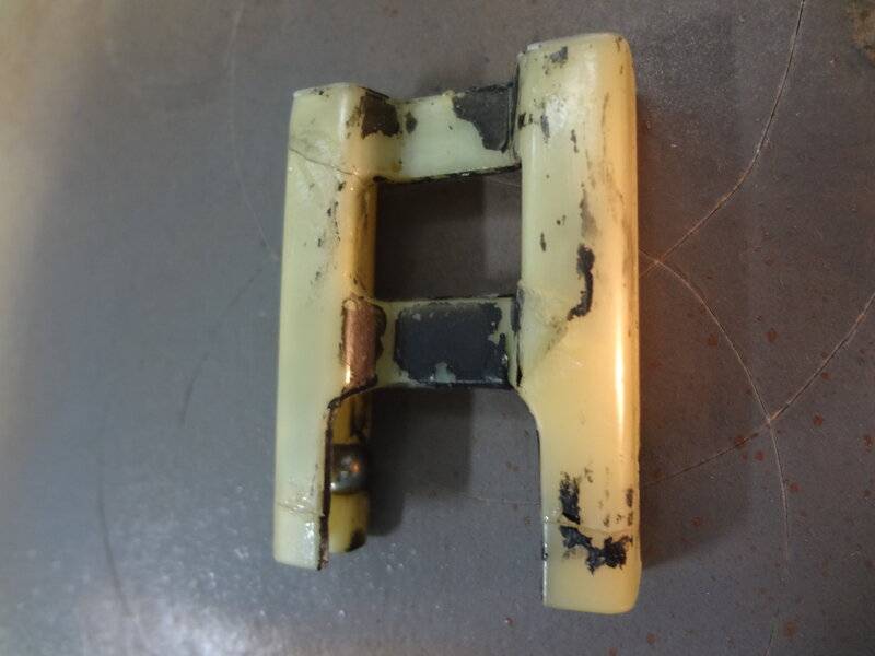

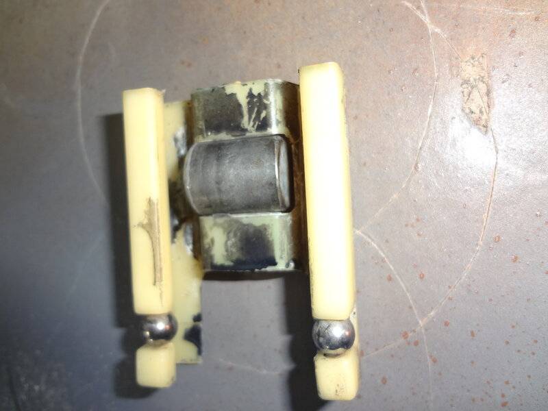

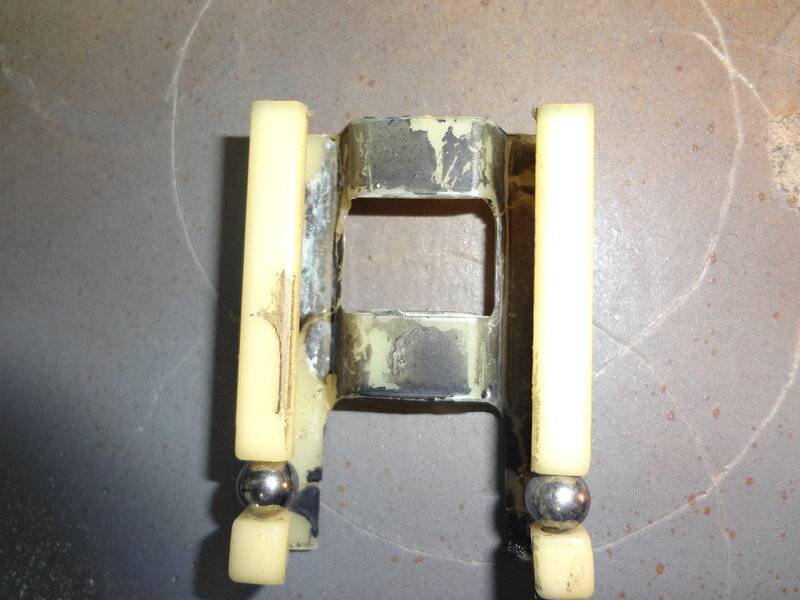

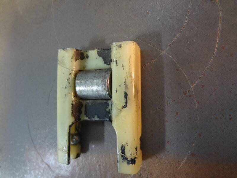

I feel your pain, I was in your shoes 2 years ago. I looked into 3D printing and making a latex mold to mold my own. Plenty of companies out there that due both. But I needed my parts in a hurry and lucked out and found a 1973 NOS bucket seat slide on ebay for $18 bucks.
My retainers were broken so I glued them back together to use them to molds or measured if needed for a CAD drawing for 3D printing. During my research I was informed that Chrysler use the same bucket seat slides up to 1978 in the Cordoba. But I never confirmed that.

View attachment 974522 View attachment 974523 View attachment 974524 View attachment 974525 View attachment 974526

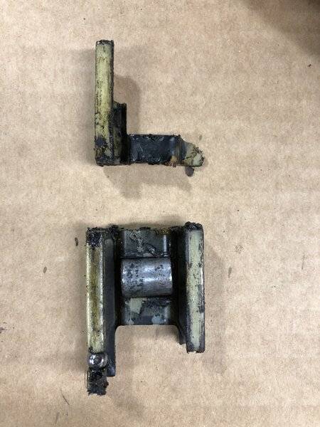

Wow, that’s great to hear that it worked out for you. That pic is of what came out of one of my seat tracks. I haven’t even taken apart the other 3 yet. I wonder what the odds would be for me to find some in a salvage yard here in south eastern Wisconsin? Oh well, I guess the search is on for some kinda fix.
