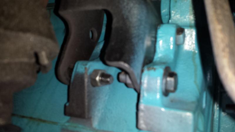

[FONT=Verdana, Arial, Tahoma, Calibri, Geneva, sans-serif]I need help please can someone w a 74 -360 B take a picture of their motor mounts n message them to me???PLEASE????[/FONT]
This is what you should have in your car as a motor mount
That is what I have! I went to change trans mount and when I removed it the trans is way off center in the tunnel and can't get new mount on. So I'm thinking one of my motor mounts are bolted to the ears on the block wrong causing the drivetrain to be crooked. So looking for pics of a 360 motor n motor mounts mounted to the K-frame..
Driver side mount. Sorry for bad picture. New to the site.
I'll have to look but I think you have the mount on wrong move it to the other side of the ears .just that little bit will throw it all off
That looks correct, as picture is upside down, but the only thing is the nuts are usually on the forward facing side, but that shouldn't make any difference.

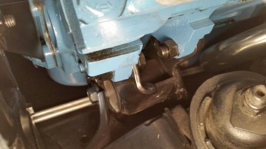

Here is a shot of my 340 driver side mount.
