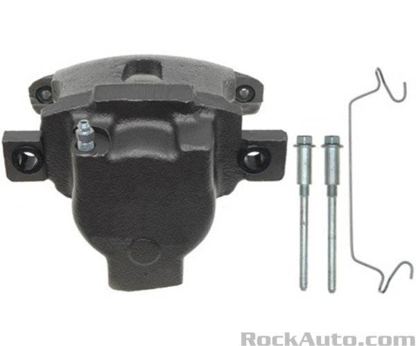

You're talking about the caliper slide bolts? I don't see them listed separately on rockauto. Worst case buy a rebuilt caliper from them since they come with pins

I was curious, rockauto does have them but they are not listed for 1974 Charger, they show 1970-72 Charger with those
