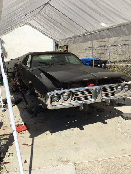

I'm in a little deeper on this '74 Charger than I thought I was gonna have to go lol.
I have mirrors, chrome, side window louvers, turn signals, etc that need hardware that was missing when I took the project on. How do you guys go about figuring out diameter/length/thread pitch on missing hardware to replace some of this stuff?
Also is there maybe a resource y'all know of where I can order it as a kit that I haven't found yet? It was pretty easy to find the interior hardware set for this car, but no luck on the exterior stuff. Attached is how she looks now, more or less.

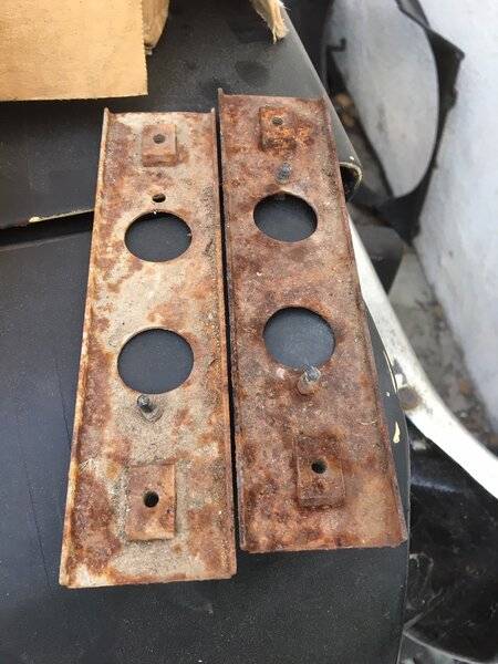

on mirrors...
Normally they use a backing plate like this:
https://www.ebay.com/itm/Mopar-Cuda...246286?hash=item593ec5e64e:g:kTAAAOSwn~Jd6rSZ
Hold by a plastic "pine tree" plugs
screws for them are available too
https://www.ebay.com/itm/70-74-Cuda...113528?hash=item592738a6f8:g:0e4AAMXQWuRQ9Xto
however you can also use the system used on 70 E bodies
https://www.ebay.com/itm/70-74-Mopa...907705?hash=item5927911079:g:IMgAAOSwd0BV1RwP
which gets a nutsert instead the backing plate. Sure the backing plate provides a better surface support for the mirror

You know, I think maybe some of those mirror brackets are in the pile of parts that came with this thing, and I just had no idea what they were. Thanks for the helping hand- one less anonymous piece of car in the pile lol

I found these in my parts bin, thanks for letting me know what they are!

With the plate you can find at a hardware store the propper screws. JUST one detail on this is I THINK the oval head is a bit smaller for these to fit into the mirror provision than the regular comercial hardware available. But is about try to fit them. Anyway, the correct ones are available as I showed you. I had to get those from that guy because couldn't find the right oval head size for them in Venezuela.
It happened the same trying to find the fender top turn signals screws, where at a regular hardware shop the correct size selftapping screw was with bigger oval head, BUT on these I got luck, because an old local upholstery shop got me a box with the correct ones.
