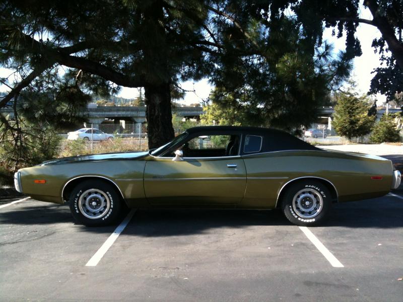

Ok, folks. Just when I get my Charger exactly the way I want it, a friend comes along and says "You gotta get dual exhausts on that thing!" I know next to nothing about changing up exhaust... any tips, recommendations of where and what to buy, advantages of trading up would be much appreciated. My '74 is completely stock with a 318 except for new wheels... but 2 pipes sticking out of the back could be pretty sweet. Don't have a pic of the rear of the monster, but here it is from the side just to give you and idea of what I'm working with.
Thanks for the feedback, I always dig learning from the Mopar crowd!
